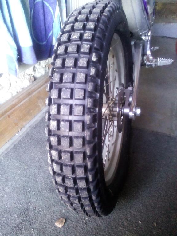

sstout Posted February 23, 2016 Author Report Share Posted February 23, 2016 here is the pic of the rear tyre.. its a Michelin X11 run at about 3-4psi in the wet, 6 in the dry, no issues in the dry ever, but nightmare on wet grass and mud... I'll check rear shock settings but its pretty soft so then it's more practice required me thinks! Quote Link to comment Share on other sites More sharing options...
topcat Posted February 23, 2016 Report Share Posted February 23, 2016 definitely well past its sell by date.... would be ok when its dry or rocky but you will struggle in the mud with that, you will be amazed at the difference a new one would make Quote Link to comment Share on other sites More sharing options...
ham2 Posted February 23, 2016 Report Share Posted February 23, 2016 definitely well past its sell by date.... would be ok when its dry or rocky but you will struggle in the mud with that, you will be amazed at the difference a new one would make :blink: Looks to me like it's still weeks away from needing to be turned? Quote Link to comment Share on other sites More sharing options...
huski Posted February 23, 2016 Report Share Posted February 23, 2016 Enduro tyres grip far more than trials tyres do in mud,but your tyre has gone well past its best before date .Get a new Michelin,it'll be miles better.Once the square edge wears off the grip diminishes noticeably Quote Link to comment Share on other sites More sharing options...
heffergm Posted February 23, 2016 Report Share Posted February 23, 2016 I'd get another 50 hours out of that tire (seriously) Quote Link to comment Share on other sites More sharing options...
