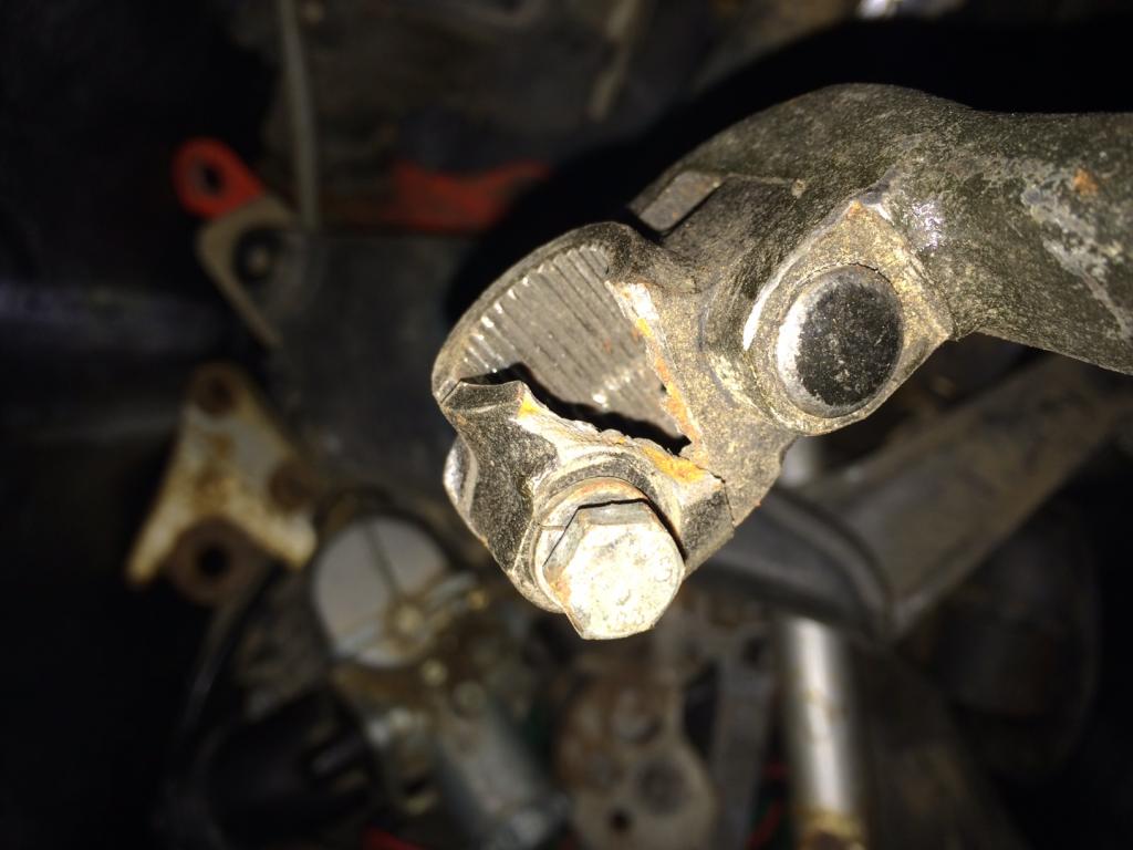

86tlr200 Posted March 9, 2016 Author Report Share Posted March 9, 2016 the cable is working properly, attached is a picture of the broken part. i would like to get a new (better) part, if im going to replace this one, rather go with a stock part. Quote Link to comment Share on other sites More sharing options...
lineaway Posted March 9, 2016 Report Share Posted March 9, 2016 Is there a kick start stop that could be bent up causing this. I seem to remember an odd piece fitted around the frame foot peg location on the USA model. Quote Link to comment Share on other sites More sharing options...
