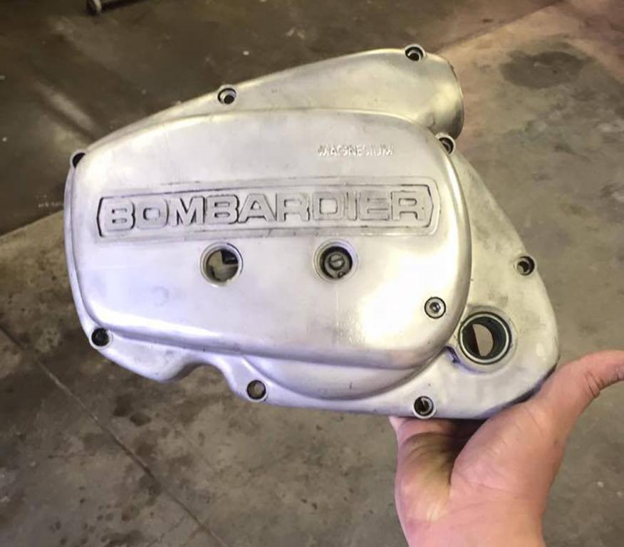

robbiesty175 Posted May 4, 2016 Report Share Posted May 4, 2016 Decided to buy an extra clutch cover and a friend is making it VERY SHINY for me!!! Should look cool. Quote Link to comment Share on other sites More sharing options...
