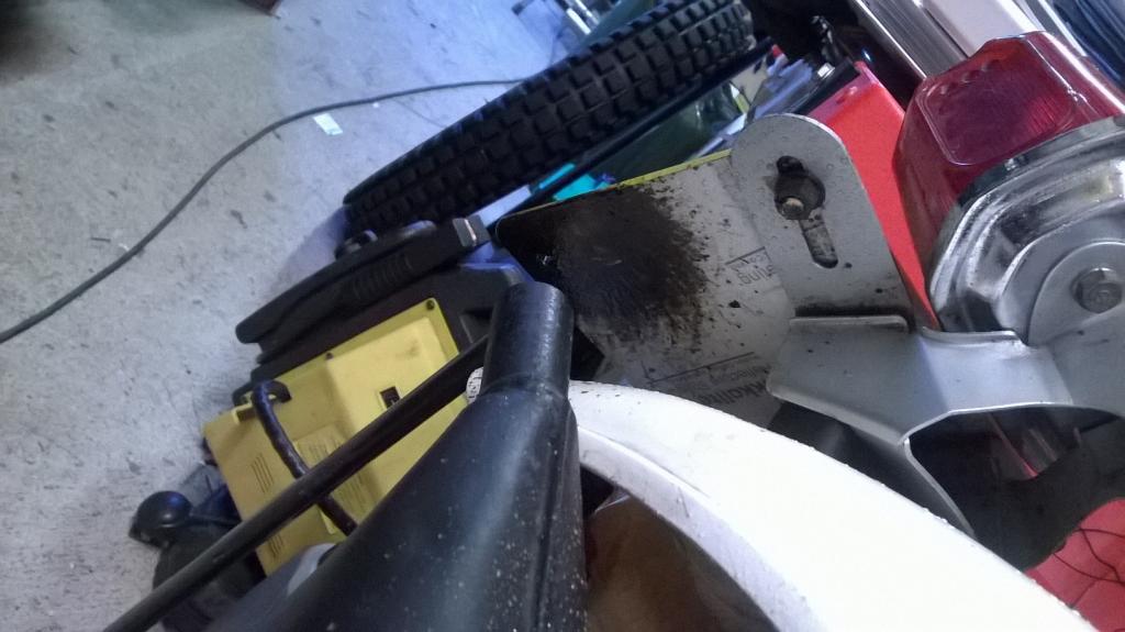

garyo Posted March 6, 2016 Report Share Posted March 6, 2016 Hi, just bought a ty125, been getting it ready to ride so done all the servicing bit n bobs. Went for a 15 min run and on return the reg plate is black with oil. I took the plug out and all the plug threads are coated in oil, do I assume the clutch side seal has gone? If so what is the procedure to repair this Quote Link to comment Share on other sites More sharing options...
tony27 Posted March 6, 2016 Report Share Posted March 6, 2016 If the clutch side crank seal goes allowing gearbox oil into the motor you can normally smell it Quote Link to comment Share on other sites More sharing options...

feetupfun Posted March 6, 2016 Report Share Posted March 6, 2016 A definitive test for the crank seal letting oil in is to look for a reduction in oil contents in the gearbox with use It's normal to have oil on plug threads It's normal to have all sorts of gunk, yes just like that, come out the end of a 2 stroke exhaust 2 Quote Link to comment Share on other sites More sharing options...
lotus54 Posted March 7, 2016 Report Share Posted March 7, 2016 Best way to test is with a 2-stroke leak down tester. But yes, if clutch side it would lower your trans fluid level- although it wouldn't take much oil to make a huge mess. Quote Link to comment Share on other sites More sharing options...

lbhbul Posted March 7, 2016 Report Share Posted March 7, 2016 Gary, Don't know where you are located, but as stated above that looks pretty normal for a 2 stroke when it can exhaust directly onto a surface, if your silencer had a turned out end so it wouldn't blow straight as it is now , you probably wouldn't see such a mess. What mixture are you running? Does the bike run pretty good as is? The pipe itself is subject to a build up over time & needs cleaned out. I am not familiar with seal replacement on a TY, but its not fun on any brand. Have a nice day Larry Quote Link to comment Share on other sites More sharing options...
garyo Posted March 7, 2016 Author Report Share Posted March 7, 2016 Hi larry, i am in norfolk uk. I am re living or trying to re live my youth. I bought the same model and year new in 1994, so exactly the same. I suspect the seals as the gunk on the back is really thick oil, this was from 15 mins running, back in the day i dont remember it being like this, also the plug is wet with black oil, again should not be like this. I changed the oil a few days ago and topped it up last night, so putting all these things together made me think of the right hand seal. I would dread to think what it would be like after an hrs running. The motor starts first kick, ticks over very well but feels lumpy and was down on power when riding it. When going into 5th it lacked pull, when going into 6th it was completely gutless Quote Link to comment Share on other sites More sharing options...

lineaway Posted March 8, 2016 Report Share Posted March 8, 2016 If the primary side seal went, it would look like a mosquito fogger. Not just a little oil. 2 Quote Link to comment Share on other sites More sharing options...

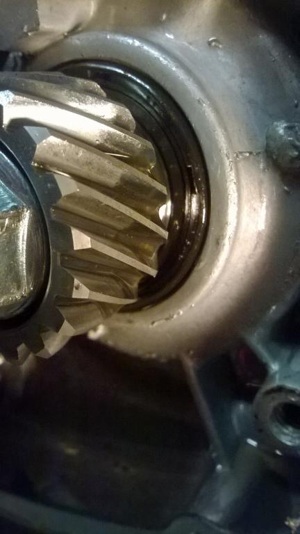

garyo Posted March 8, 2016 Author Report Share Posted March 8, 2016 Started to strip the side off ready for the parts coming, it looked like the seal is in backwards as i could see the internal spring, but the pic does not really show what i seen, it was evident someone gas been here before. Question what direction are the idler gear and clutch basket nuts Quote Link to comment Share on other sites More sharing options...

garyo Posted March 9, 2016 Author Report Share Posted March 9, 2016 Seal not in backwards as a double lip and spring seal. I bought the clutch n flywheel tool that is brill, got it all stripped and the seal out, i noticed that the oring was missing from the bike, so assume this has been causing the issue? The seal kit has this oring, looking at the dwg it shows the seal, then the o ring then the spacer, so does the oring sit on the shaft and the spacer buts it against the casing, or does the oring go on the spacer and but against the seal, i dont know, help please Cheers Gary Quote Link to comment Share on other sites More sharing options...
tony27 Posted March 10, 2016 Report Share Posted March 10, 2016 The o-ring is to seal the inside of the spacer to the crankshaft, without it there is nothing to prevent oil etc migrating along the shaft. It's a strange design but seems to be common to most Yamaha 2 strokes for quite some time, my 81 YZ465 has it as well & the YZ490s are the same so the idea stayed around until the 90s Quote Link to comment Share on other sites More sharing options...
