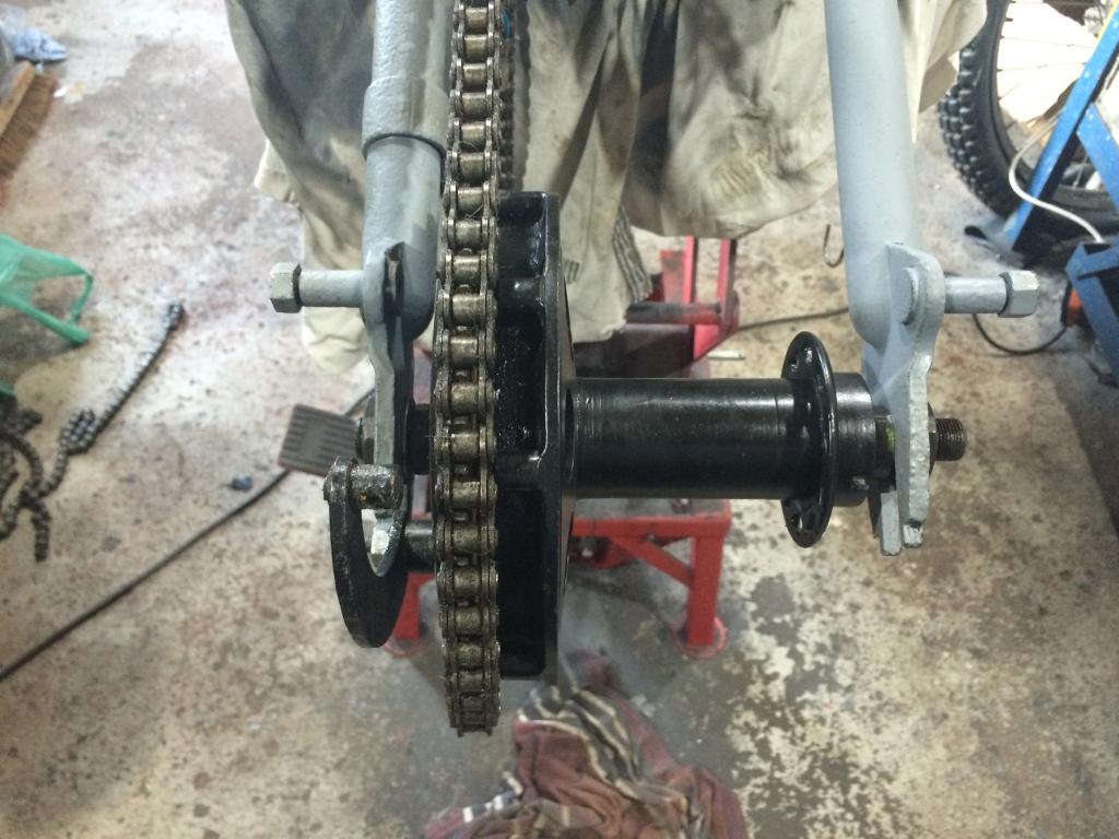

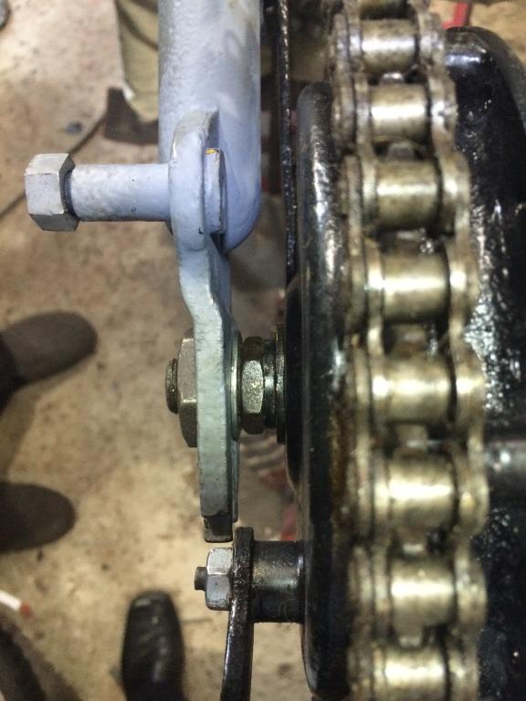

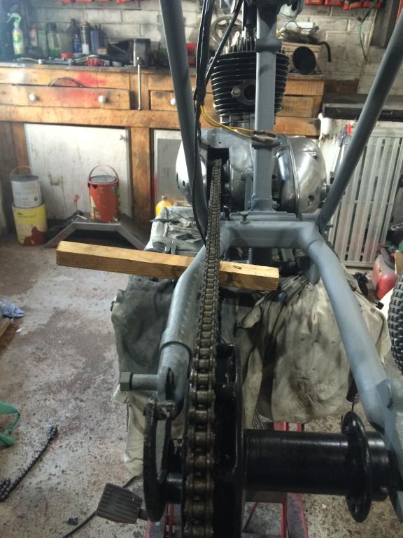

john b Posted March 12, 2016 Report Share Posted March 12, 2016 As per pictures below, I have fitted engine (which is offset to give clearance) - and have widened swinging arm. Ive got the rear hub in what I think is the correct alignment measuring as best I can, I can then measure to get correct spacers manufactured. Is there an easy way to check front to back sprocket alignment ? cheers John Quote Link to comment Share on other sites More sharing options...

old trials fanatic Posted March 12, 2016 Report Share Posted March 12, 2016 Straight edge clamped to the sprocket works for me. Your motor doesnt look straight in the frame ? might just be parallax error. 1 Quote Link to comment Share on other sites More sharing options...
john b Posted March 13, 2016 Author Report Share Posted March 13, 2016 Thanks for the replies - I think the easy one at the minute is clamping a straight edge to the sprocket Old trials fanatic - you're right - engine does look offset, however I'm sure just angle of the photo cheers John 1 Quote Link to comment Share on other sites More sharing options...
