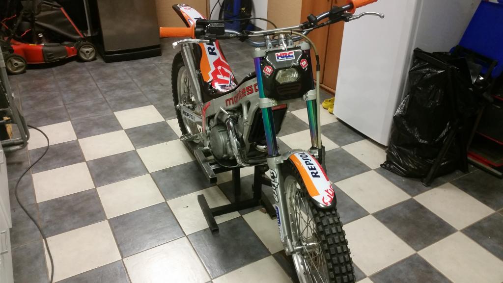

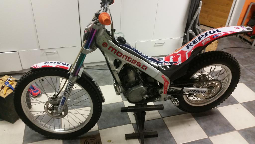

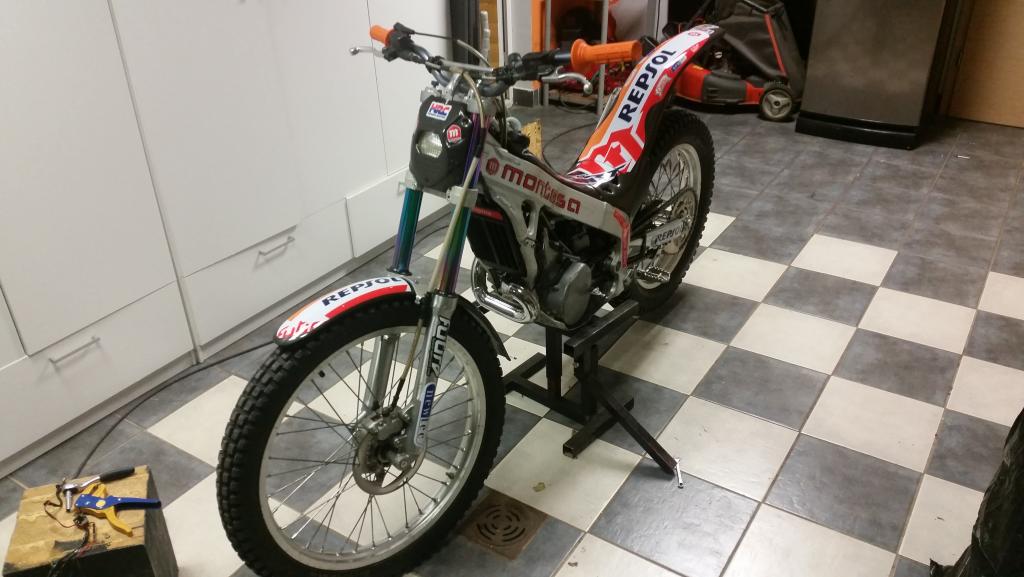

cross1 Posted March 23, 2016 Report Share Posted March 23, 2016 Hello! I am new in the world of trial so i need to learn a lot. I have just purchased 2003 315r for and it is so much fun to ride. What I have noticed during my first few rides is that radiator fan is running a lot. This means that soon after sturtup it starts running and is runing more or less the whole time. The bike doesn`t owerheat yet, but I don`t know what will happen in a summer months. Is this normal? I have checked coolant and it`s ok. Radiator is not blocked. I am riding mostly tails in 3rd, 4th gear, so I gues wind mooving trough the radiator should cool the engine enough to switch of the fan. Here is allsoa few pics of my new machine! Quote Link to comment Share on other sites More sharing options...
