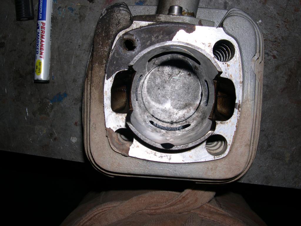

christian Posted March 28, 2016 Report Share Posted March 28, 2016 Hi Gary and all reading this. I would like to see a photo from your engine with the Marcelle barrel. I believe that I have one on my Greeves. (will post a photo later) Thanks. Christian. Quote Link to comment Share on other sites More sharing options...
trialsrfun Posted March 28, 2016 Report Share Posted March 28, 2016 Hi Christian, The MotoX cylinder & head are rectangular when viewed from above, wider left/right thanfront/rear. The fins at the upper part of the cylinder are wider than the lower ones exactly as on the picture above of Maurice riding his bike. Quote Link to comment Share on other sites More sharing options...
christian Posted March 28, 2016 Report Share Posted March 28, 2016 Here are some photos of my greeves. Quote Link to comment Share on other sites More sharing options...
garyhib Posted March 28, 2016 Author Report Share Posted March 28, 2016 Hi all,Christian,the picture of Maurices barrel/head is the same as what i've picked up.The angles,spaceing, shape and height are spot on. Could yours be a 'Parkinson' or a DMW? I'm sure someone can tell you.All the best. Quote Link to comment Share on other sites More sharing options...
trialsrfun Posted March 28, 2016 Report Share Posted March 28, 2016 Hi Christian, Your Greeves is very nice but I cannot identify the cylinder other than to say it is not a MotoX conversion, how does the engine performance compare to other Villiers bikes you may have ridden. Quote Link to comment Share on other sites More sharing options...
christian Posted March 28, 2016 Report Share Posted March 28, 2016 (edited) On 3/28/2016 at 3:50 PM, trialsrfun said: Hi Christian, Your Greeves is very nice but I cannot identify the cylinder other than to say it is not a MotoX conversion, how does the engine performance compare to other Villiers bikes you may have ridden. The Greeves is my spare bike when the Norton is out and it is a completely different riding( is it a surprise? ) Once I get used to brutalise the throttle when I need power, it works quite well, it is very soft at low rev's and almost unstopable, about power, it is not my Norton but I really love to ride the greeves (not as much as the Norton thou). Compared to other Greeves I could test, there is a small lack of response at low revs. There is something strange on this engine, the conrod is the short one , I believe from the 190cc Villiers. Was it a modification they used to do?? I own this Greeves from 2005, and never saw one with the same barrel. Hello Deryk, on the photo you posted the barrel seems wider and head fins arrangement is not the same. Thanks for your replies. Christian. Edited March 28, 2016 by christian Quote Link to comment Share on other sites More sharing options...
trialsrfun Posted March 28, 2016 Report Share Posted March 28, 2016 (edited) Hi Christian the first type of engine similar to the one you have in the Greeves was 9E 197cc with a 5 1/4" conrod, when this engine was enlarged to 246cc the barrel base flange was increased in thickness by 1/4" to add strength because of the greater power output, this required the rod to be lengthened by 1/4" to 5 1/2" these were the A series engines 32a 34a 37a. My knowledge of the alloy barrels is mostly Greeves, DOT, Ajax for the 197 to 225 conversion and late DMW. Parkinson, Marcelle and others also made cylinders but these I am unfamiliar with, possibly someone with engineering connections could have produced one or more as well. The last type of DMW cylinder was designed for use with the shorter 5 1/4" conrod, all Greeves and DOT barrels that I have come across use the longer rod as does the MotoX conversion that Garyhib has. Irrespective of rod length the stroke remains the same at 72mm. The porting in your cylinder appears to be very similar to the other Villiers fit barrels but without accurate measurements from known cylinders it is not possible to say. Often the greatest visible difference is the size/shape of the inlet port but maybe the biggest perfomance vaiation would be due to the type of head and compression ratio used. Hope this helps. Edited March 28, 2016 by trialsrfun Quote Link to comment Share on other sites More sharing options...
christian Posted March 29, 2016 Report Share Posted March 29, 2016 (edited) On 3/28/2016 at 8:02 PM, trialsrfun said: Hi Christian the first type of engine similar to the one you have in the Greeves was 9E 197cc with a 5 1/4" conrod, when this engine was enlarged to 246cc the barrel base flange was increased in thickness by 1/4" to add strength because of the greater power output, this required the rod to be lengthened by 1/4" to 5 1/2" these were the A series engines 32a 34a 37a. My knowledge of the alloy barrels is mostly Greeves, DOT, Ajax for the 197 to 225 conversion and late DMW. Parkinson, Marcelle and others also made cylinders but these I am unfamiliar with, possibly someone with engineering connections could have produced one or more as well. The last type of DMW cylinder was designed for use with the shorter 5 1/4" conrod, all Greeves and DOT barrels that I have come across use the longer rod as does the MotoX conversion that Garyhib has. Irrespective of rod length the stroke remains the same at 72mm. The porting in your cylinder appears to be very similar to the other Villiers fit barrels but without accurate measurements from known cylinders it is not possible to say. Often the greatest visible difference is the size/shape of the inlet port but maybe the biggest perfomance vaiation would be due to the type of head and compression ratio used. Hope this helps. Hi trf, very good to read your interesting comments. I have also , what I believe is a very late DMW barrel and head. If I could find the time to fit it !!!! The Norton is still going strong and is reliable, so there is no need to improve the Greeves for the moment. Regards. Christian. Edited March 29, 2016 by christian Quote Link to comment Share on other sites More sharing options...
