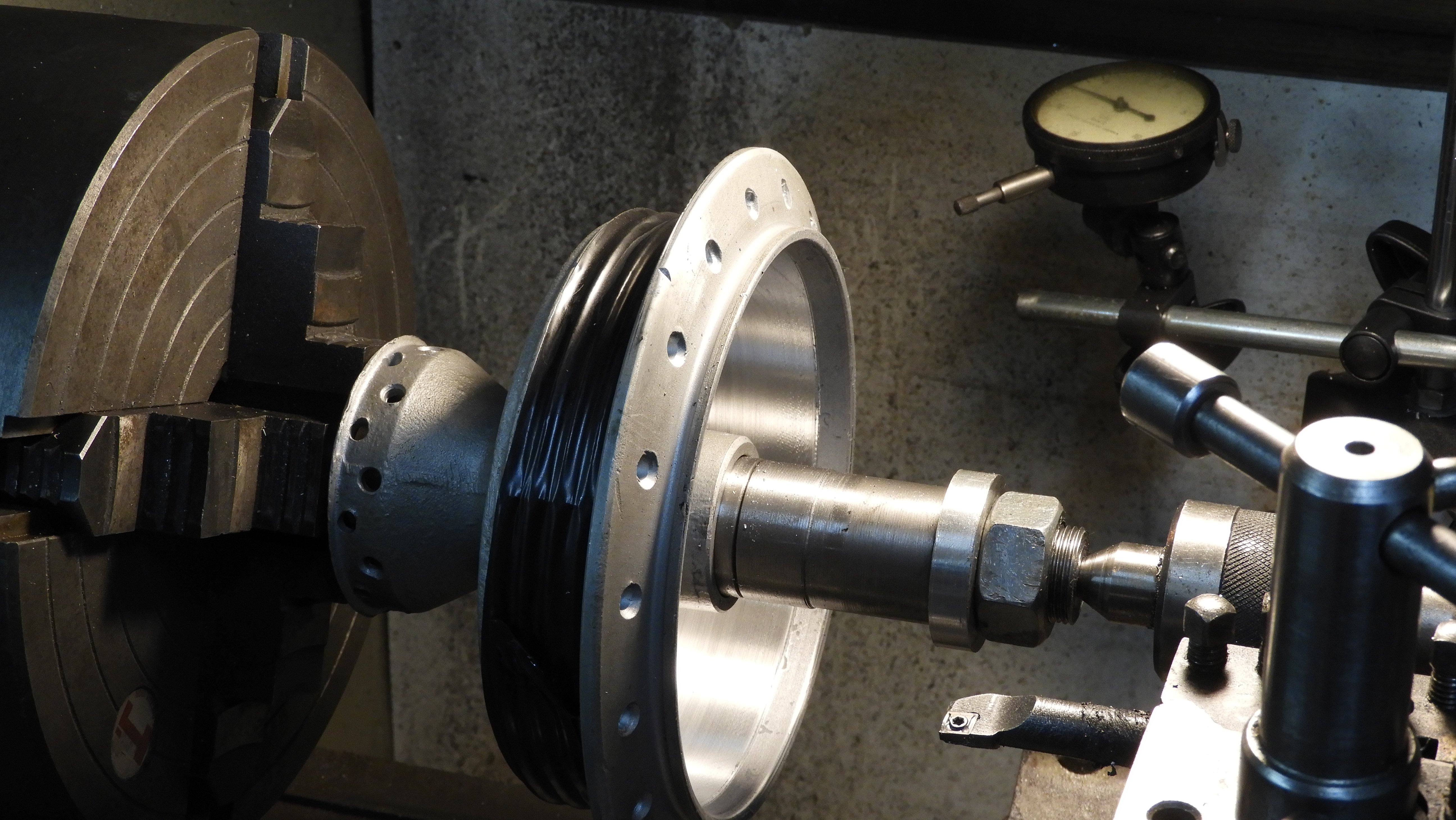

Richard Sawatzki Posted October 1, 2019 Report Share Posted October 1, 2019 Westwood Cylinder Liners uk do a liner, WCL41BFL , Bore 124, Dia 129.96, length 259.16, about £85 all in. I have machined my hubs 127mm rear, 128mm front , going to give this liner a try, will update if successful. 5 1 Quote Link to comment Share on other sites More sharing options...

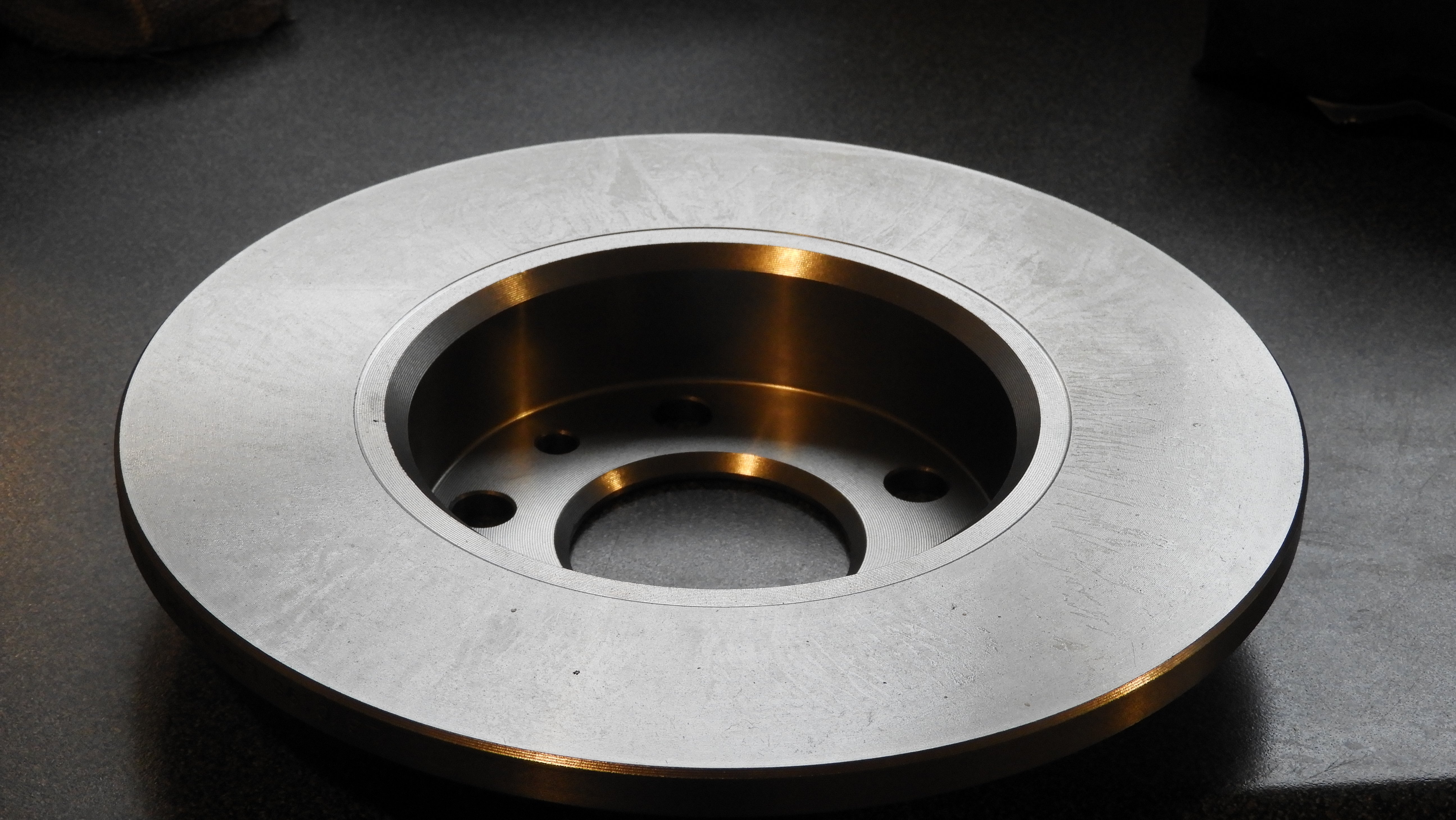

Richard Sawatzki Posted October 14, 2019 Report Share Posted October 14, 2019 Just a update on the hub re line, found this brake disc (NDB776), has 23mm ID and plenty of meat on the out side, would leave quite a thin insert, but think it would be ok. Quite a lot of machining, but half the price of the liner, only £35 a pair,so this might be a new option. Will update when I figure out which way I go with this. 3 Quote Link to comment Share on other sites More sharing options...
Bricole 63 Posted October 16, 2019 Report Share Posted October 16, 2019 Salut C'est vrai,prendre un disque de frein comme base pour usiner la frette est une bonne idee car comme les chemises de moteur ,la fonte employee est coulee avec centifugeation ce qui permet de ne pas avoir de soufflures de coulee dans la matiere. J'avais cite des chemises de moteur car je suis un ancien mecanicien poids lours et a l'epoque on reconditionnait les moteurs ,mais on ne faisait pas d'echange standard,donc les vieilles chemises envahissaient les poubelles. Claude Quote Link to comment Share on other sites More sharing options...
midgy Posted December 3, 2020 Report Share Posted December 3, 2020 In reply to Richard Sawatzki about a pair of NDB776 car brake discs, what car are they from? 1 Quote Link to comment Share on other sites More sharing options...
delberto Posted December 4, 2020 Report Share Posted December 4, 2020 https://www.ebay.co.uk/itm/NATIONAL-NBD776-BRAKE-DISC-SINGLE-/114368140725 spelling i think Quote Link to comment Share on other sites More sharing options...
