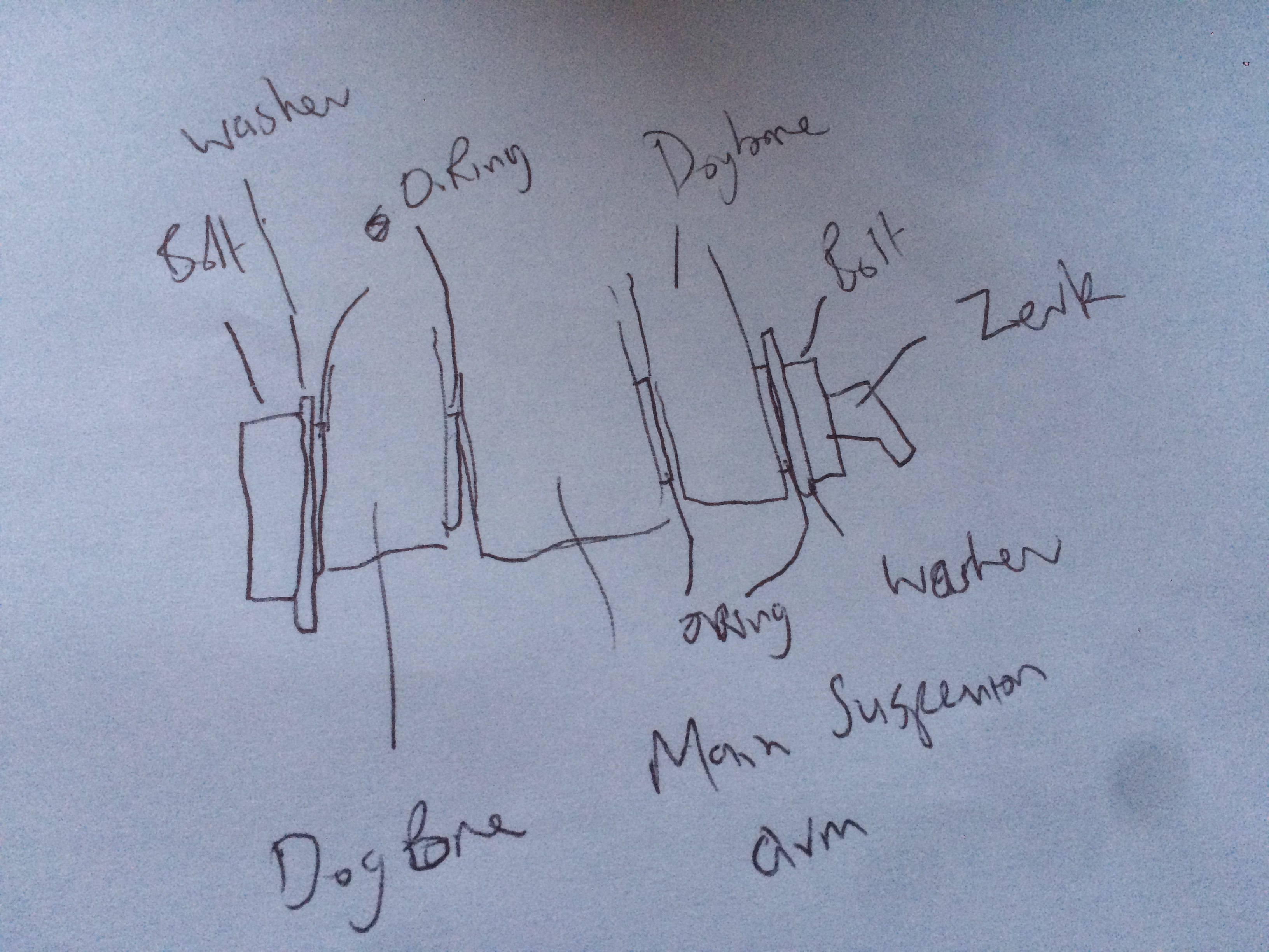

lotus54 Posted February 23, 2017 Author Report Share Posted February 23, 2017 Not a good picture- darn it. But I hope you can see the 90º zerk (I think 1mm thread pitch?) Here is what I did. For that pin that the 90º zerk is going into- there is a bolt on the other side. I put a small washer such that even with both bolts quite tight, there is a just a bit of clearance, so the pin/arms can move well. It doesn't take much. So a washer between the bolt and pin on the left side. Quote Link to comment Share on other sites More sharing options...
jsp Posted February 23, 2017 Report Share Posted February 23, 2017 no thats ok, is the 90d nipple close to the frame ? Quote Link to comment Share on other sites More sharing options...
b40rt Posted February 23, 2017 Report Share Posted February 23, 2017 http://www.ebay.co.uk/sch/i.html?_odkw=90+degree+grease+nipple&_osacat=0&_from=R40&_trksid=p2045573.m570.l1313.TR0.TRC0.H0.X90+degree+grease+nipple+1mm+thread.TRS0&_nkw=90+degree+grease+nipple+1mm+thread&_sacat=0 Quote Link to comment Share on other sites More sharing options...
jsp Posted February 23, 2017 Report Share Posted February 23, 2017 I've found out there a m6 x 0.75mm thread which I've manage to track down and order some spares Quote Link to comment Share on other sites More sharing options...
lotus54 Posted February 23, 2017 Author Report Share Posted February 23, 2017 7 hours ago, jsp said: no thats ok, is the 90d nipple close to the frame ? Yes, that is it. If you shim too far- the nipple with hit the frame. Quote Link to comment Share on other sites More sharing options...
jsp Posted February 24, 2017 Report Share Posted February 24, 2017 sorry for all the questions and the poor drawing, but where had you added the shim, and are you adding it to extend the centre bolt slightly to give it a bit more play ? 1 Quote Link to comment Share on other sites More sharing options...
