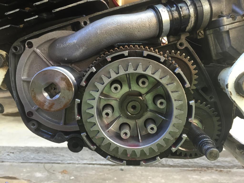

Pulled the clutch cover off my Rotax 240 motor (tucked into an Armstrong/Can-Am frame, so thanks for allowing me into the SWM family!) due to the clutch sticking, even after warm.  The prior owner ran some pretty thick gear oil, and the motor sat many years unloved.  I prefer ATF, but things are still sticky.

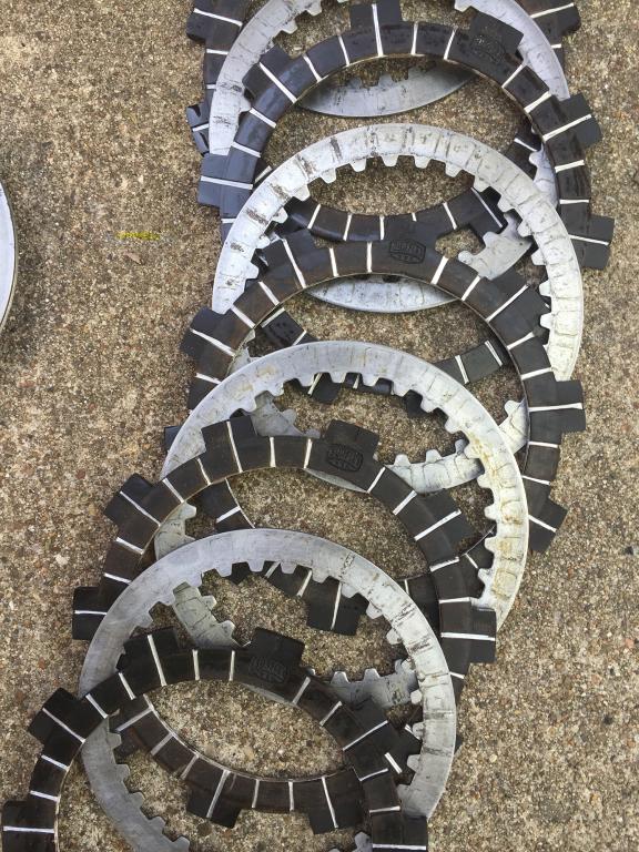

Discovered five friction plates and six steel plates.  Should there be another friction plate?

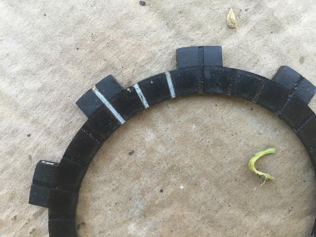

I am in the process of cleaning off the gaps in the plates, as I found some good material on this procedure elsewhere.  I've attached the pdf.

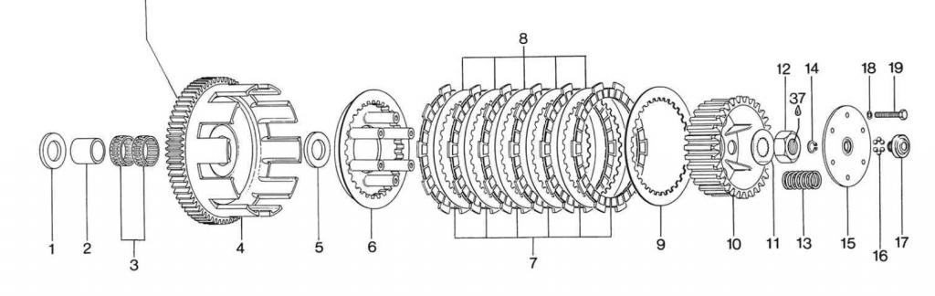

Hi, there are so many different permutations and who know's what's been tried with your clutch ?
Normally there are six of each. The stack height is usually around 32mm. The outer plain plate is usually 0,5 to 1 mm thicker than the others.
With time,  the standard friction material swells up apparently, thus causing the drag. The fact that the clutch usually drags when cold even with new plates seems to say it has not really much to do with the age of the plates themselves.

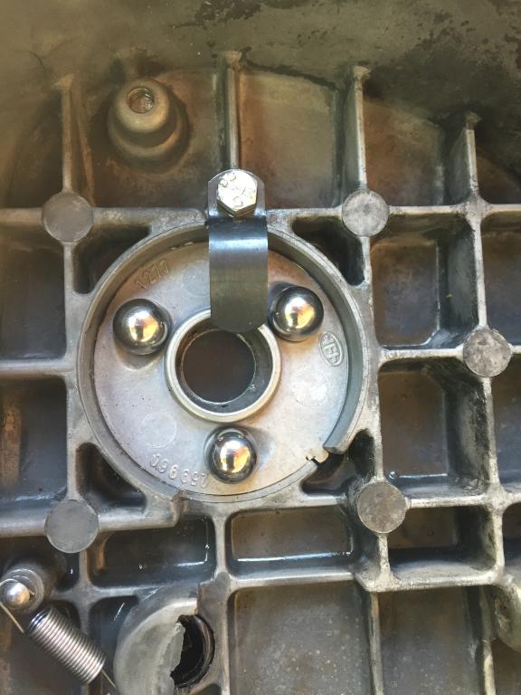

about the command, I use the original little balls (in teory a point of contact of a ball is independently of the ball diameter....) the original command with 10 mm longer lever and I remove the external ring that slide to the magnesium and I add a device in the same center of the adjust bolt ingaging the external of the thrust bearing to mantain centered the command....
