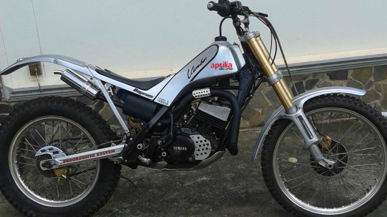

papa al Posted April 21, 2016 Report Share Posted April 21, 2016 100% newbie, but old. Just bought a old April Climber, site-unseen; had delivered. Bike seems mostly okay, but the rotors are rusty & pitted. The rear brake does not work well at all. The hydraulics & pads are good and seem to be contacting ok. Should I consider getting the rotors turned or is rusty okay, as the seller insists? Thanks. Quote Link to comment Share on other sites More sharing options...
lineaway Posted April 21, 2016 Report Share Posted April 21, 2016 Just clean up the rust, but that caliper sure looks funny upside down! Quote Link to comment Share on other sites More sharing options...
papa al Posted April 21, 2016 Author Report Share Posted April 21, 2016 Okay. Clean it up on a lathe, sandpaper/ steel wool? Rust is pretty heavy & pits. Maybe papa just worry too much. Up-side-down? You jus' messing' wi' papa, right? Quote Link to comment Share on other sites More sharing options...
pschrauber Posted April 21, 2016 Report Share Posted April 21, 2016 That's an interesting Hybrid? Seems to be a Yamaha and maybe Italian blend haven't seen such a bike before. Some more pics? Quote Link to comment Share on other sites More sharing options...
john.b Posted April 21, 2016 Report Share Posted April 21, 2016 (edited) He is not messing Papa! The plastic disc guard and caliper need swapping places. Guard to go on the bottom and the caliper on the top. Having said that I think the plastic guard will be the wrong way round once fitted, just buy a new guard! Edited April 21, 2016 by john.b Quote Link to comment Share on other sites More sharing options...
tshock250 Posted April 21, 2016 Report Share Posted April 21, 2016 What engine is that??? Did he tell you it had been converted? Quote Link to comment Share on other sites More sharing options...
lineaway Posted April 21, 2016 Report Share Posted April 21, 2016 The Aprilia had the chain on the rh side. Looks like they flipped the tire around and flipped the swingarm upside down. Quote Link to comment Share on other sites More sharing options...
tshock250 Posted April 21, 2016 Report Share Posted April 21, 2016 What does it turn like with the forks raked-out like that? Quote Link to comment Share on other sites More sharing options...
feetupfun Posted April 22, 2016 Report Share Posted April 22, 2016 (edited) The frame appears to be modified with the front end of a Yamaha trailbike frame. The motor looks like Yamaha single cylinder air cooled off-road bike from the 1970s, I'm thinking early IT175 except for the cylinder head which looks like it is from a Yamaha road bike The front end is from a late 1980s early 1990s trials bike (Aprilia Climber era) The Aprilia swingarm appears to have been fitted upside down so that the chain is on the side that suits the Yamaha motor Edited April 22, 2016 by feetupfun Quote Link to comment Share on other sites More sharing options...
dan williams Posted April 22, 2016 Report Share Posted April 22, 2016 Somebody's project bike. http://www.thaivisa.com/forum/topic/870186-my-air-cooled-monoshock-trials-bike-project-pic-heavy/# 1 Quote Link to comment Share on other sites More sharing options...
papa al Posted April 22, 2016 Author Report Share Posted April 22, 2016 Bingo. Swing arm ends were cut off, swapped, and rewelded to accommodate switch. Quote Link to comment Share on other sites More sharing options...
2stroke4stroke Posted April 22, 2016 Report Share Posted April 22, 2016 Surely if you were going to the effort of doing all that you would do it such that the caliper would last more than five minutes in rocky going? Quote Link to comment Share on other sites More sharing options...
papa al Posted April 23, 2016 Author Report Share Posted April 23, 2016 I would welcome advice on how to accomplish that. Surely that would be easy for you to figure out. Rear calliper surely has survived > 5 min @ rocky to date. [some people like to exaggerate and talk shie, no prob.] Quote Link to comment Share on other sites More sharing options...
papa al Posted April 23, 2016 Author Report Share Posted April 23, 2016 He is not messing Papa! The plastic disc guard and caliper need swapping places. Guard to go on the bottom and the caliper on the top. Having said that I think the plastic guard will be the wrong way round once fitted, just buy a new guard! If only that were possible! Large Brembo calliper casting encloses the axel. Quote Link to comment Share on other sites More sharing options...
