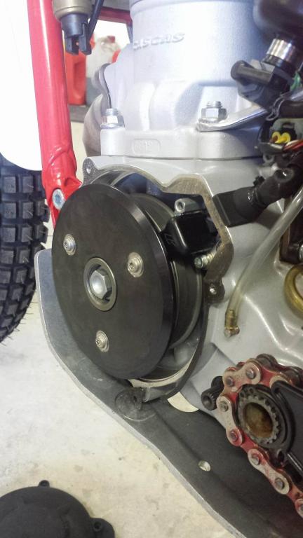

jml Posted April 28, 2016 Report Share Posted April 28, 2016 (edited) Hey all, Recently bought this TXT Pro Racing 2015 125cc second hand and was wondering if this is a flywheel weight or standard? The manual seems to show a similar unit but it's hard to tell if it's exactly the same from the aspect of the image. Many thanks! Edited April 28, 2016 by jml Quote Link to comment Share on other sites More sharing options...
jml Posted April 28, 2016 Author Report Share Posted April 28, 2016 Also: Does anyone have a photo of a TXT Pro 125 flywheel just for reference, I cannot find a photo anywhere! Quote Link to comment Share on other sites More sharing options...
crazybond700 Posted April 28, 2016 Report Share Posted April 28, 2016 Here is a picture of a 14 http://buffalodream.smugmug.com/S3-225-Kit/i-gt3n74Q/0/L/150311%20223%20Kit%20Installed%20%2B%20Flywheel-L.jpg Quote Link to comment Share on other sites More sharing options...
jml Posted April 28, 2016 Author Report Share Posted April 28, 2016 (edited) Here is a picture of a 14 http://buffalodream.smugmug.com/S3-225-Kit/i-gt3n74Q/0/L/150311%20223%20Kit%20Installed%20%2B%20Flywheel-L.jpg The 14's flywheel seems to be a little different to the 15, the 15 has the recess around the the flywheel bolt which hugs the black disc. I'm trying to find someone who has a 2015 125 who's willing to take a picture to set my mind at ease as I still cannot confirm if it's a factory flywheel as it looks so damn similar to the one in the parts manual Edited April 28, 2016 by jml Quote Link to comment Share on other sites More sharing options...
crazybond700 Posted April 28, 2016 Report Share Posted April 28, 2016 (edited) The 125cc has a different number as the rest of the range (ET70000CT-CGC-1 vs. ET70000CT-CGI-1) And if you look at http://www.thehellteam.com/ignition-stator-flywheel-kit-racing-15.html#prettyPhoto[media_gallery]/0/ It does seem the original 125. On the 14 model it has also a different code ET700001208 vs. ET700003013. So both difference in model year, and in engine size. My bed it is original on the 2015 model. Also I cannot find any weight with the three holes like in your picture. It also makes sence you want a ''original'' weight on it, being a 125cc bike. Edited April 28, 2016 by crazybond700 1 Quote Link to comment Share on other sites More sharing options...
jml Posted April 28, 2016 Author Report Share Posted April 28, 2016 My bed it is original on the 2015 model. Also I cannot find any weight with the three holes like in your picture. It also makes sence you want a ''original'' weight on it, being a 125cc bike. Thanks crazybond, I'm starting to see it's more than likely you're right and it's original. I've got a friend who is going to take some photos of their 2015 125 over the weekend, I'll post up the photos just in case anyone else stumbles upon this problem. Thanks for the help 1 Quote Link to comment Share on other sites More sharing options...
jfc Posted April 28, 2016 Report Share Posted April 28, 2016 The photo of your bike flywheel is standard, my sons is exactly the same and we have had it from new. Great bike the extra development of the 15 125 really did make a big difference! 2 Quote Link to comment Share on other sites More sharing options...
jml Posted April 28, 2016 Author Report Share Posted April 28, 2016 The photo of your bike flywheel is standard, my sons is exactly the same and we have had it from new. Great bike the extra development of the 15 125 really did make a big difference! Thanks jfc, I've been looking for this answer all day Quote Link to comment Share on other sites More sharing options...
