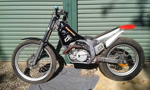

whitehillbilly Posted July 2, 2016 Report Share Posted July 2, 2016 After a bit of a tidy up. Runs ok. Just waiting on AJP Brake/Clutch master cylinders to arrive next week sometime. 1 Quote Link to comment Share on other sites More sharing options...
