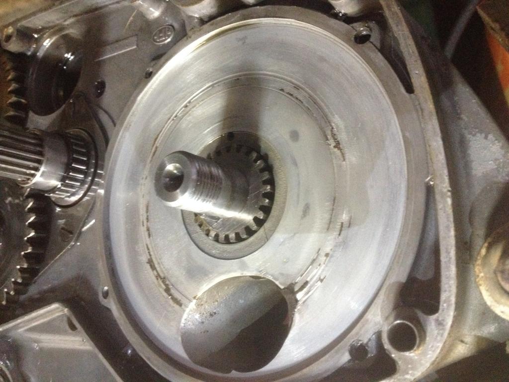

strugglinon Posted May 7, 2016 Author Report Share Posted May 7, 2016 Well, it's just interesting. Pulled the disc valve apart tonight and oh dear, oh deary me! Quote Link to comment Share on other sites More sharing options...

strugglinon Posted May 8, 2016 Author Report Share Posted May 8, 2016 I'm thinking, well it's knackered anyway so I might as well try a chemical metal, dremel and a rubbing block. Nothing to lose really? Any ideas? Quote Link to comment Share on other sites More sharing options...
pschrauber Posted May 8, 2016 Report Share Posted May 8, 2016 You might get a donor engine case in any case a new disc. I wouldn't try using knead metal JB-weld or similar stuff as through vibration a part of the repaired spots can get loose and the output would be similar to what you have now. Engines do show up here and there ask the community here look at LeBonCoin in France, Kiiji and Subito in Italy. (Had a likewise problem with my TR so needed too the basement which I found for good price in Italy). Quote Link to comment Share on other sites More sharing options...

strugglinon Posted May 8, 2016 Author Report Share Posted May 8, 2016 I'm in Cumbria b40rt I may as well give it a try pschrauber before I try to buy new cases. Could be interesting? Quote Link to comment Share on other sites More sharing options...
b40rt Posted May 8, 2016 Report Share Posted May 8, 2016 Defiantly have some climber cases, will check condition if your interested ? I'm in Edinburgh. 1 Quote Link to comment Share on other sites More sharing options...
strugglinon Posted May 8, 2016 Author Report Share Posted May 8, 2016 Yeah man, have a look. Cheers 1 Quote Link to comment Share on other sites More sharing options...
