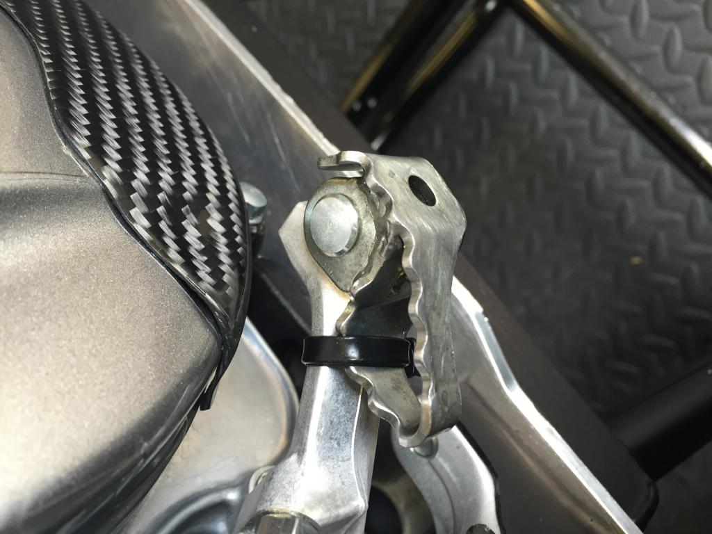

duggan Posted May 28, 2016 Report Share Posted May 28, 2016 I also find the standard brake pedal is a little to far away so I cable tie it back on it self and bend the front edge back, makes a big difference. 1 Quote Link to comment Share on other sites More sharing options...

trial bike Posted May 28, 2016 Author Report Share Posted May 28, 2016 Duggan. Spot on. I have just tried that myself. I didn't strap it all the way back, because it looked a little tucked in. I strapped it about 1/3 to 1/2 way back. It is nigh on perfect. A brilliant idea, should have thought of it myself. My foot is now a little further back on the peg, how I like it, and the pedal is right under the front of my boot. Simple and free! Thanks chap. Quote Link to comment Share on other sites More sharing options...
trial bike Posted May 28, 2016 Author Report Share Posted May 28, 2016 JohnnyC, Reading your post again after having done the Duggan suggestion, I think that is exactly what you meant, eh? I can't believe the difference it makes. Its given me much more confidence that the brake is going to be there when I need it. I don't have to keep looking down anymore to see if it is with in reach, and I don't have to keep shifting my foot forward. Like they say, the simple fixes are often the best. Quote Link to comment Share on other sites More sharing options...
jonnyc21 Posted May 28, 2016 Report Share Posted May 28, 2016 (edited) JohnnyC, Reading your post again after having done the Duggan suggestion, I think that is exactly what you meant, eh? I can't believe the difference it makes. Its given me much more confidence that the brake is going to be there when I need it. I don't have to keep looking down anymore to see if it is with in reach, and I don't have to keep shifting my foot forward. Like they say, the simple fixes are often the best. Yes this is what my friend did, however he forced a large round punch through the center of the folding portion of the peddle to open it up a bit more so it wasn't as tucked in. Edited May 28, 2016 by jonnyc21 Quote Link to comment Share on other sites More sharing options...
