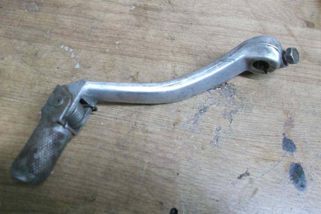

trialsguy8 Posted June 1, 2016 Report Share Posted June 1, 2016 (edited) Hey guys, I have a 2003 rev 3 and I'm having issues with the spring that holds the shifter peg on, I can't for the life of me work out how it fits? I put it on as best I could however after riding the bike tonight, the spring has sprung off and is doing nowt.. Leaving the gear peg in an awkward-gear shifting-pointing towards the rear-position.. Am I doing something stupid here? Damn spring is driving me crazy, how is it supposed to fit? Thanks fellas Edited June 1, 2016 by trialsguy8 Quote Link to comment Share on other sites More sharing options...

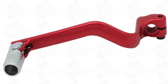

bilks Posted June 1, 2016 Report Share Posted June 1, 2016 (edited) Should look like this or were the u shape is that might be straight.to keep the spring in tension, Edited June 1, 2016 by bilks Quote Link to comment Share on other sites More sharing options...
