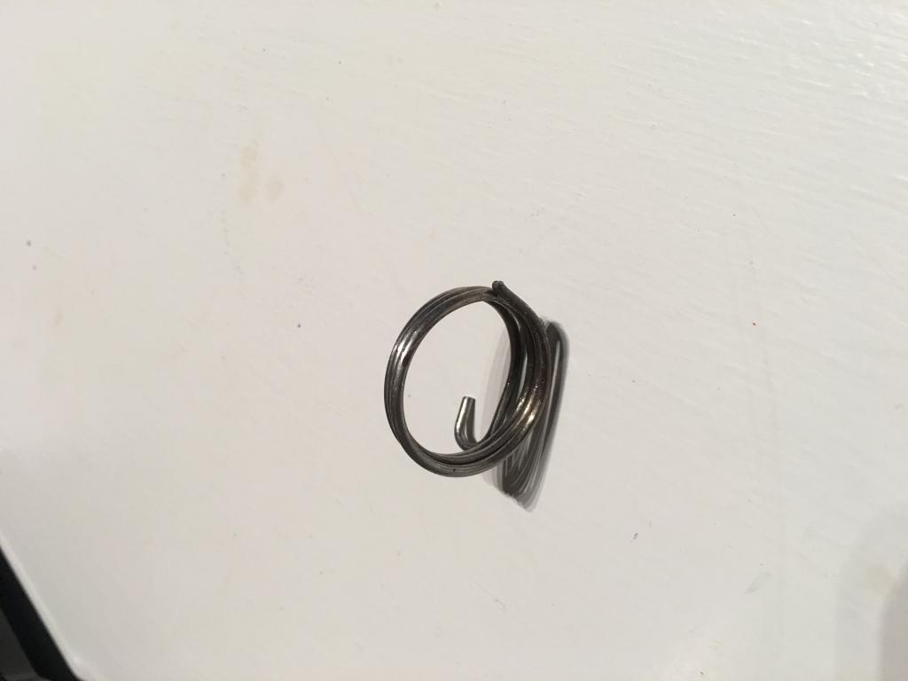

africanjon Posted June 7, 2016 Author Report Share Posted June 7, 2016 Comparing my spring to the fiche it would seem a section has broken off? I cannot get the spring to catch with the notch on the swingarm? Quote Link to comment Share on other sites More sharing options...
lotus54 Posted June 7, 2016 Report Share Posted June 7, 2016 Yes, it is broken. Get a couple, although the replacement I got has lasted for some 200 hours. trials and Trivulations in England or Lewisport in the States have them. Not much cost Quote Link to comment Share on other sites More sharing options...
