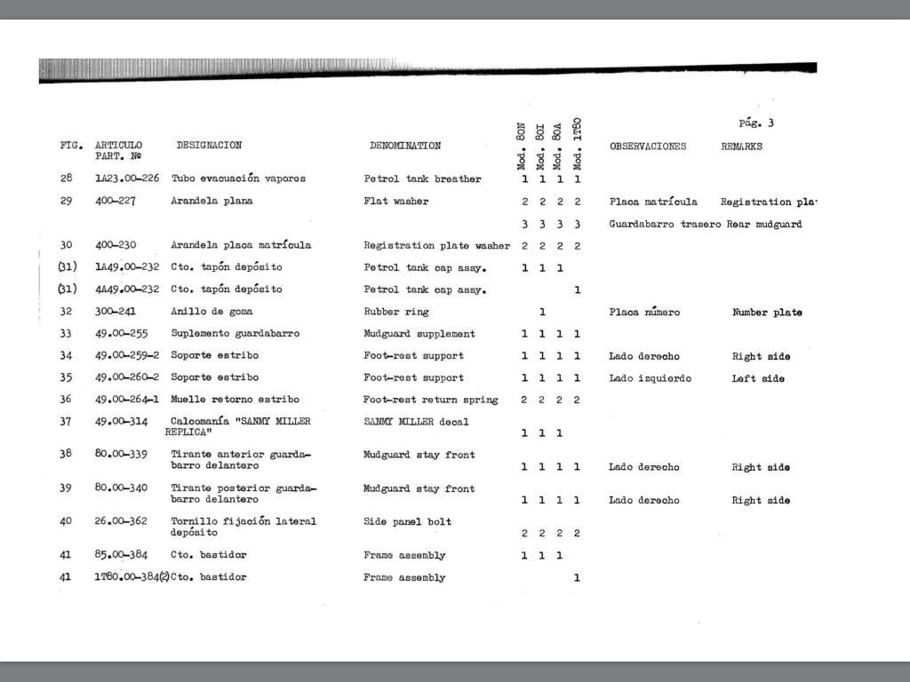

My understanding was that the Model 80 was the last of the "Sammy Miller Replica" bikes from Bultaco.
The Model 80 spare parts book pages" below has "Miller Replica" decal listed as No. 37.
