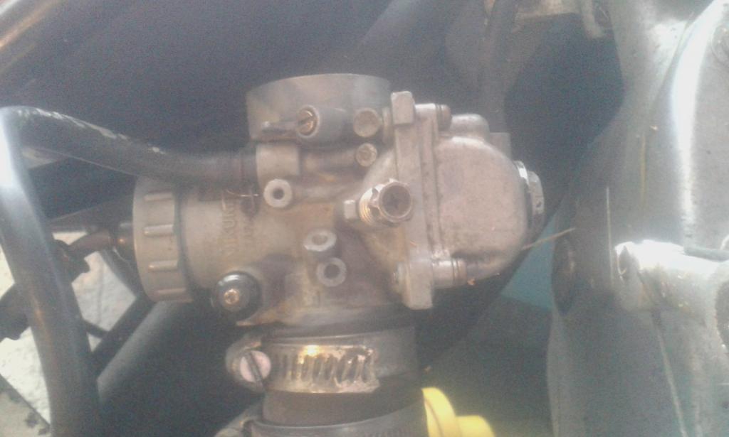

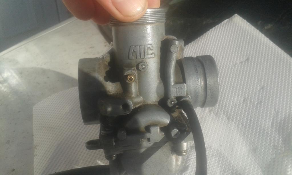

netley Posted July 17, 2016 Author Report Share Posted July 17, 2016 Hi, Thanks for all the replies. I wondered if anyone could identify this carb? That way I can make sure I have the correct settings and float height. I'll be adding the air filter Tuesday. Cheers Quote Link to comment Share on other sites More sharing options...
netley Posted July 18, 2016 Author Report Share Posted July 18, 2016 I think I have answered my own question having taken some higher quality pics and googled the numbers on the carb. https://yamahaclub.com/forums/topic/28494-dt-175-mx-main-jets/ see advice from Airhead. Not really suitable for an engine nearly twice the capacity ? Neil 1 Quote Link to comment Share on other sites More sharing options...
feetupfun Posted July 18, 2016 Report Share Posted July 18, 2016 A Yamaha 3U5 carby is a bit small for a 325. Marginally OK on a trials 250. I run that size Yamaha-Mikuni on my 210cc TY175 and it goes great 1 Quote Link to comment Share on other sites More sharing options...

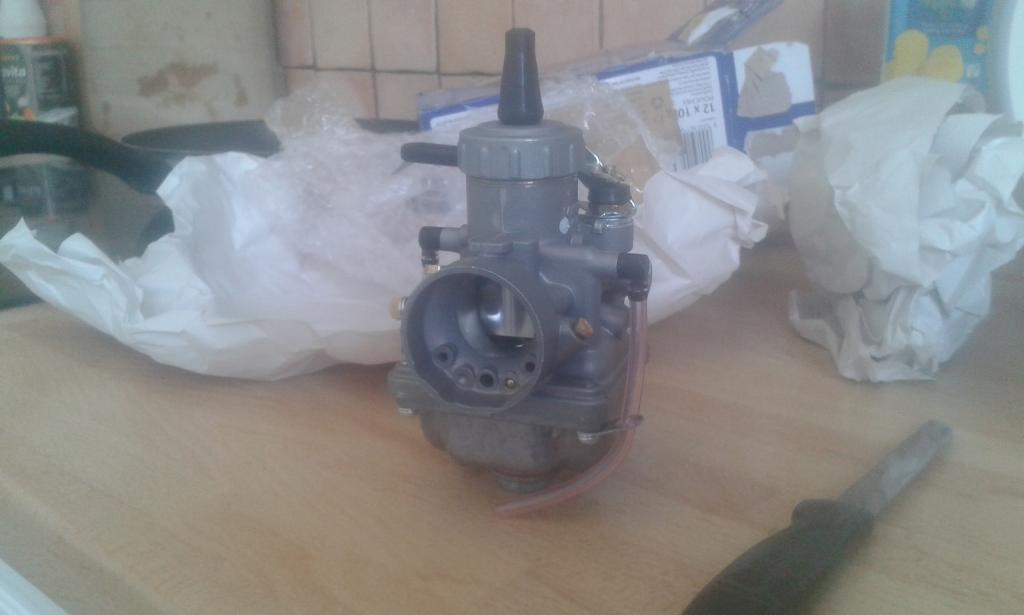

netley Posted July 19, 2016 Author Report Share Posted July 19, 2016 (edited) This should do the job. The Mikuni it should have fitted. Edited July 19, 2016 by netley 3 Quote Link to comment Share on other sites More sharing options...
