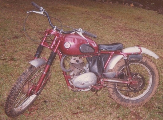

whitehillbilly Posted August 6, 2016 Report Share Posted August 6, 2016 (edited) I have a 1960 Greeves, with a 32A motor. I live in Australia, and 20 odd years ago, sent my coil to hi-output coils, In Victoria. They rewound it, and has been faultless. Cost was about 40 quid, and it runs the standard setup, but has the HT lead soldered to the coil. I had a 1956 James trials, 6E motor,which ran an external coil, much like you are doing. I picked up a roadster rolling chassis, then later a 6E motor. I stripped the first lot of wire from the coil ( secondary windings ? ) then ran a wire from the original coil winding left on it, to the external coil, which also had a external condenser fitted to it. It has changed hands a couple of time, and a few changes made, but is still being used at Trials in Queensland Au, the last picture below A mate with a 150 Villiers, took the wires off the coil, counting the turns from the primary and secondary windings. Took two samples to the local electric motor rebuilders, to get the sizing, and length, when wound the wire back on, finishing with a shellac coating. 20 years later still going strong. whitehillbilly Edited August 6, 2016 by whitehillbilly 2 Quote Link to comment Share on other sites More sharing options...
