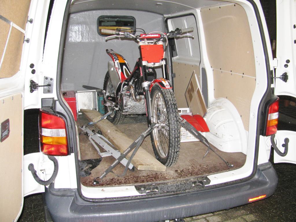

guys Posted July 11, 2016 Report Share Posted July 11, 2016 This is how I do it. Rock solid. 3 Quote Link to comment Share on other sites More sharing options...
b40rt Posted July 11, 2016 Report Share Posted July 11, 2016 This is how I do it. Rock solid. Klaar voor de Trial Des Carrières in Choumont-Gistoux 001.JPG Ok for a straight road, to much leverage for sudden manoeuvres. 1 Quote Link to comment Share on other sites More sharing options...
