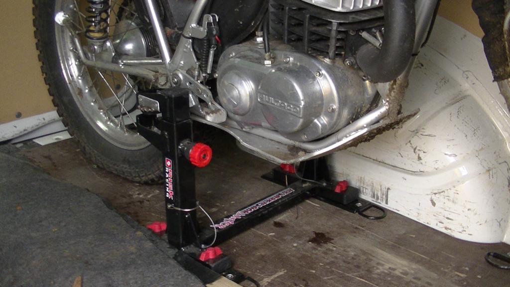

guys Posted November 12, 2016 Report Share Posted November 12, 2016 I'm currently trying this system out. Makes it able to put the bike very close to the side, so there's more room for other stuff. Quote Link to comment Share on other sites More sharing options...
nigel dabster Posted November 12, 2016 Report Share Posted November 12, 2016 Probably the quickest and easiest system i ever came across was Munch's one (the late departed M Sport motesa guru) which attached a small bracket to the wheel arch similar position of bike to the old Bulto above. The bracket was a couple of inches below normal footrest height so the bike was compressed on suspension to fit under then a captive bolt was dropped down through footrest hole. excellent system so simple. 1 Quote Link to comment Share on other sites More sharing options...
