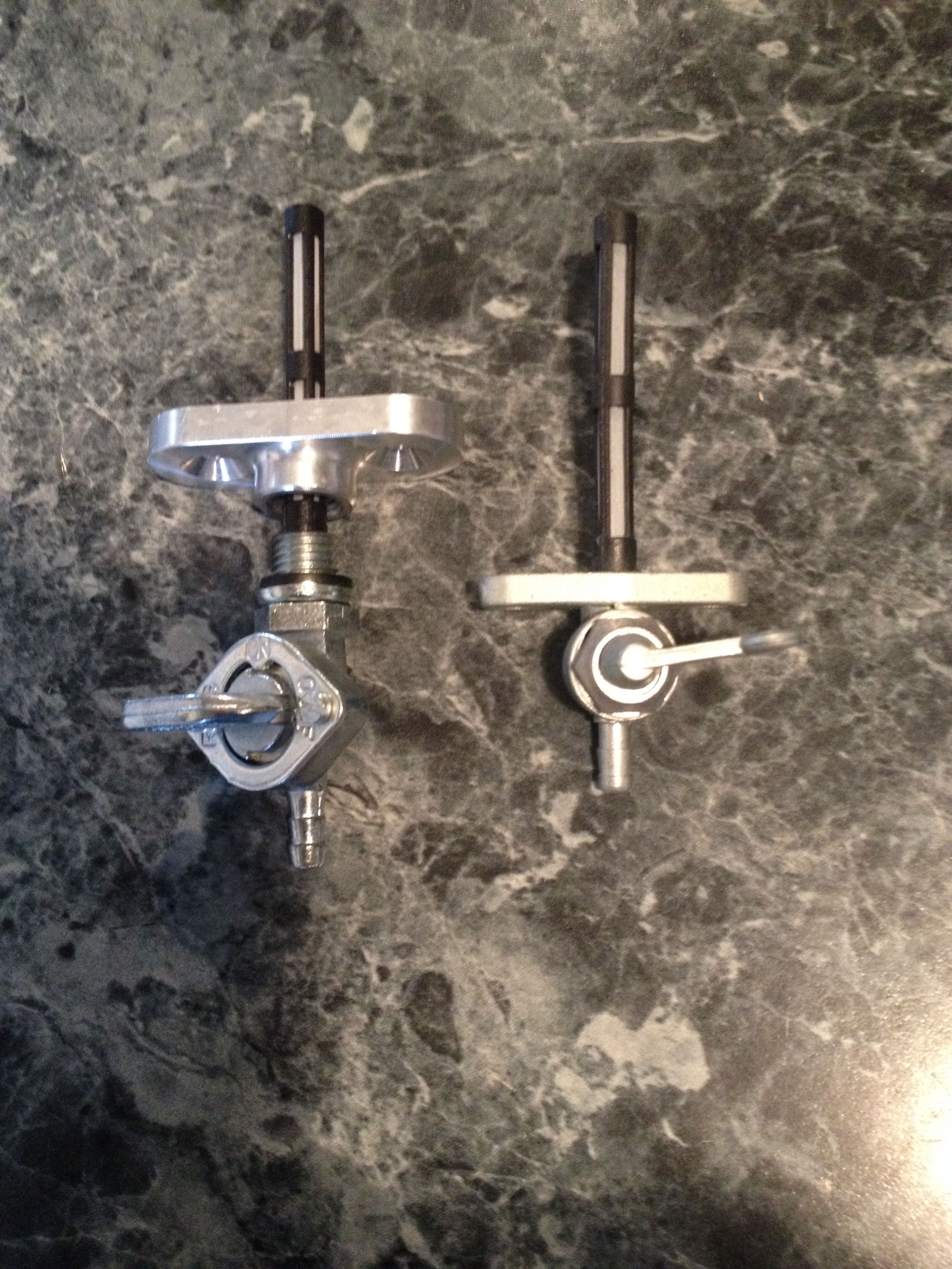

There are a couple of taps that fit the original tank, two of mine have early model Sherco taps which have the same bolt spacing and I just realised that the tap I purchased off inmotion has a detachable 12mm threaded part, that screws into a block that has the two 6mm holes, so it looks like it would fit the earlier style fitting, so in effect it would fit both styles of tank.
PS I would check with them first as I don't have an earlier tank to test this out on.
