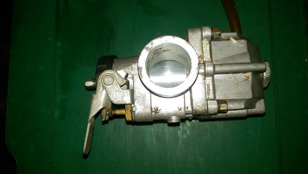

feetupfun Posted July 15, 2016 Report Share Posted July 15, 2016 On 7/15/2016 at 4:14 PM, oldmxer said: feetupfun, thank you for your info, sorry but can you please confirm AMAL Mk 2 choke lever operation: You stated choke Lever up = ON, this places the plunger down "IN" which you also say is OFF, I really appreciate your help but now I am now very confused ! Maybe your AMAL Mk2 is different to this one? This shows one with the "choke" on (plunger out) 1 Quote Link to comment Share on other sites More sharing options...

oldmxer Posted July 16, 2016 Author Report Share Posted July 16, 2016 scot taco, I confirm the filler cap hole is clear, again this was one of my first checks but failed to mention this in my forum. pschrauber, thank you for your advise but I have sprayed WD40 around the head, cylinder base and induction while engine is running to see if anything is either sucked in or pushed out. feetupfun, thank you for the choke position clarification. stevem75, thank you for the above in-depth information, I will work my way through this forum and hopefully source this problem. Can I say a big thank you to Trials Central for allowing everyone to pass on this constructive information in this Forum, well done, Graham 1 Quote Link to comment Share on other sites More sharing options...
naichuff Posted July 16, 2016 Report Share Posted July 16, 2016 I have just looked at my Amal Mk2 The choke lever is on the left and the plunger on the right I push the lever down to start and up to run or hot starting and is the same as those on the Amal web site It is the carb that left the left the factory with the bike Quote Link to comment Share on other sites More sharing options...
oldmxer Posted July 17, 2016 Author Report Share Posted July 17, 2016 Hi naichuff, thanks for that, this is the same condition as mentioned in the photo from feetupfun, its good to get the correct understanding Quote Link to comment Share on other sites More sharing options...
