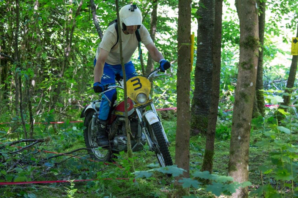

onthegas Posted July 20, 2016 Report Share Posted July 20, 2016 (edited) I have an M98 Alpina that I restored to running condition 12 years ago. A couple years after that I turned it into a "Sherpina" for riding vintage trials and rode about a half dozen trials. Seven years ago I was given a basket-case M91 (that had been in a fire). The gears, heavier primary-side flywheel, single-row chain and clutch basket from the M91 made their way into the M98. Shortly after that I moved and only used the bike to ride around in the woods following my kids when they were learning to ride. Last year I entered my first trial, in six years, and noticed the bike was having some issues, but figured I was just rusty at riding trials. This year I picked up a TL125 and a TY80 for my boys and I to ride trials together. Last month we entered a trials and I was having a lot of carburetion issues, so I pulled apart the Amal and found the slide was worn out. I replaced the old Amal with a Mikuni VM26, checked the timing (still in spec.) and cleaned the air filter. All the old problems (hard-starting, flooding, running lean) have disappeared. A couple weeks ago I went to a friends place to practice for a day. One thing I noticed was when crawling through a section at idle the bike lurches to the point where I have to use the clutch and throttle to keep the engine speed up. It was doing this with the Amal carb too, but the other problems sort of overshadowed this one. This makes the bike very difficult to ride in tight sections. I can ride the TL or the TY in the same tight section and not even touch the clutch. Lurching was never an issue when I rode the bike before in competition. After I swapped out the internal parts with those from the M91 I never rode the bike in competition. I'm thinking the heavier primary-side flywheel is the culprit here even though the. engineer in me says a heavier flywheel would have the opposite effect. Has anyone else experienced a similar issue? Edited July 20, 2016 by onthegas Quote Link to comment Share on other sites More sharing options...
