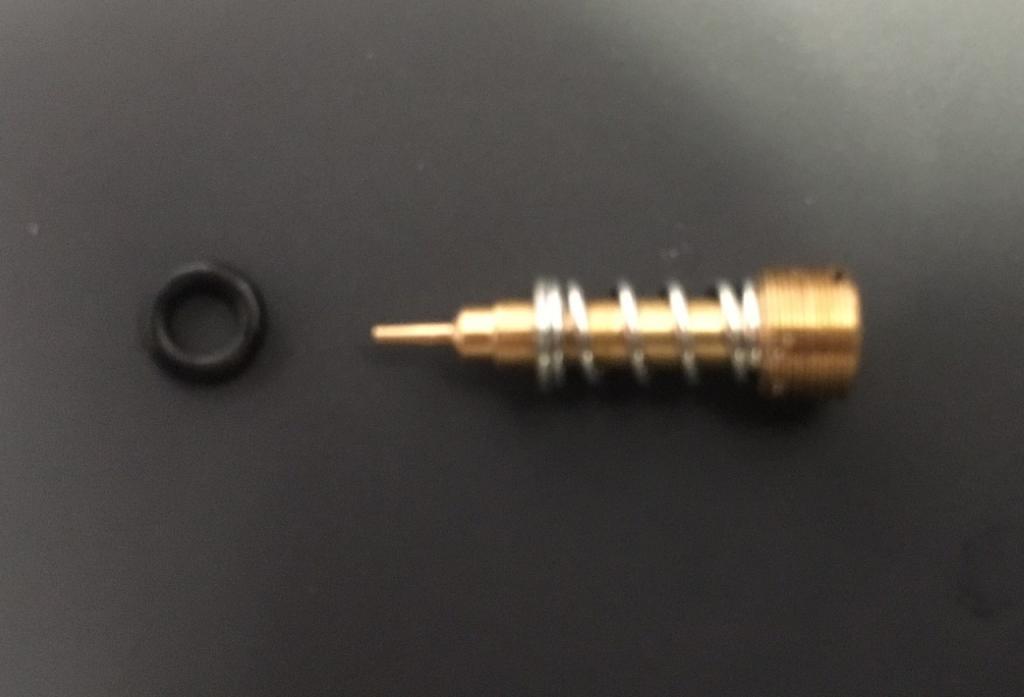

billyt Posted July 28, 2016 Report Share Posted July 28, 2016 Here you go..... 1 Quote Link to comment Share on other sites More sharing options...

billyt Posted July 31, 2016 Report Share Posted July 31, 2016 No washers on the Beta 4T carb fuel screw. Just the jet, spring and O ring. Quote Link to comment Share on other sites More sharing options...

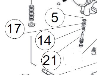

dowsonm Posted August 1, 2016 Author Report Share Posted August 1, 2016 Billy - the 2010 bike has a washer in addition to the O-ring so maybe they removed it on later models. It is shown on the parts diagram: Thanks for the feedback so far. Not there yet, but still trying things to improve the bike's running. Quote Link to comment Share on other sites More sharing options...
