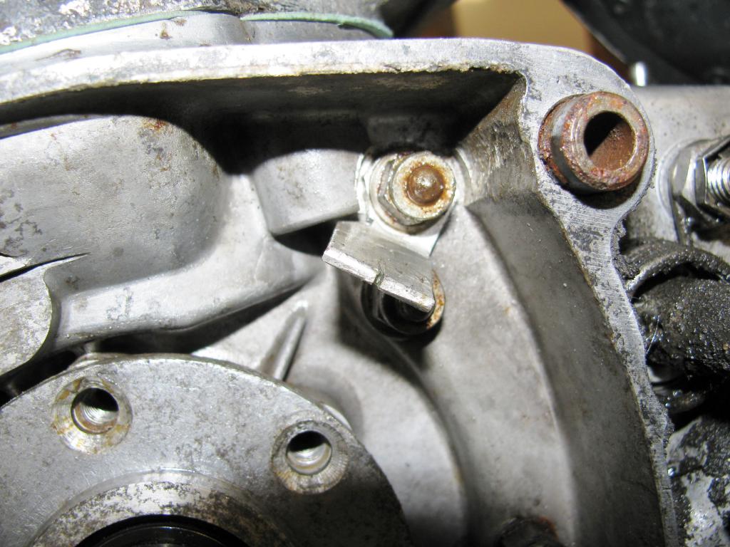

netley Posted August 19, 2016 Author Report Share Posted August 19, 2016 Hi, Rain stopped so time to play. Just checking, Does everything look ok in this pic of the coil wiring. Going to check the timing hasn't moved since I set it first. It's been stood for quite a while and then used quite a bit of a week so I suppose it's possible the mains or the seals have given up. Is there a way to check this? Thanks for looking. Neil Quote Link to comment Share on other sites More sharing options...
noel063 Posted August 19, 2016 Report Share Posted August 19, 2016 You may have just answered your own question. Seals are inexpensive and easy to do. 1 Quote Link to comment Share on other sites More sharing options...
netley Posted August 19, 2016 Author Report Share Posted August 19, 2016 Timing had slipped. Why they don't put some timing marks on the flywheel I don't know. Put some tape on flywheel and crankcase and then used a cigarette paper to get the right opening point. Fired easily and ran until warm and ticked over. I stopped it and tried again and all well. I will see how things progress as there will be trouble with the seals at some point I'm sure. Thanks for all the advice. Quote Link to comment Share on other sites More sharing options...
guys Posted August 19, 2016 Report Share Posted August 19, 2016 "Why they don't put some timing marks on the flywheel I don't know." I made my own permanent timing markings on the flywheel. One at TDC and one at 2,6mm before TDC. These correspond with the marking on the small aluminium piece I mounted in the top right of the flywheel casing. Easy peasy. 5 Quote Link to comment Share on other sites More sharing options...
