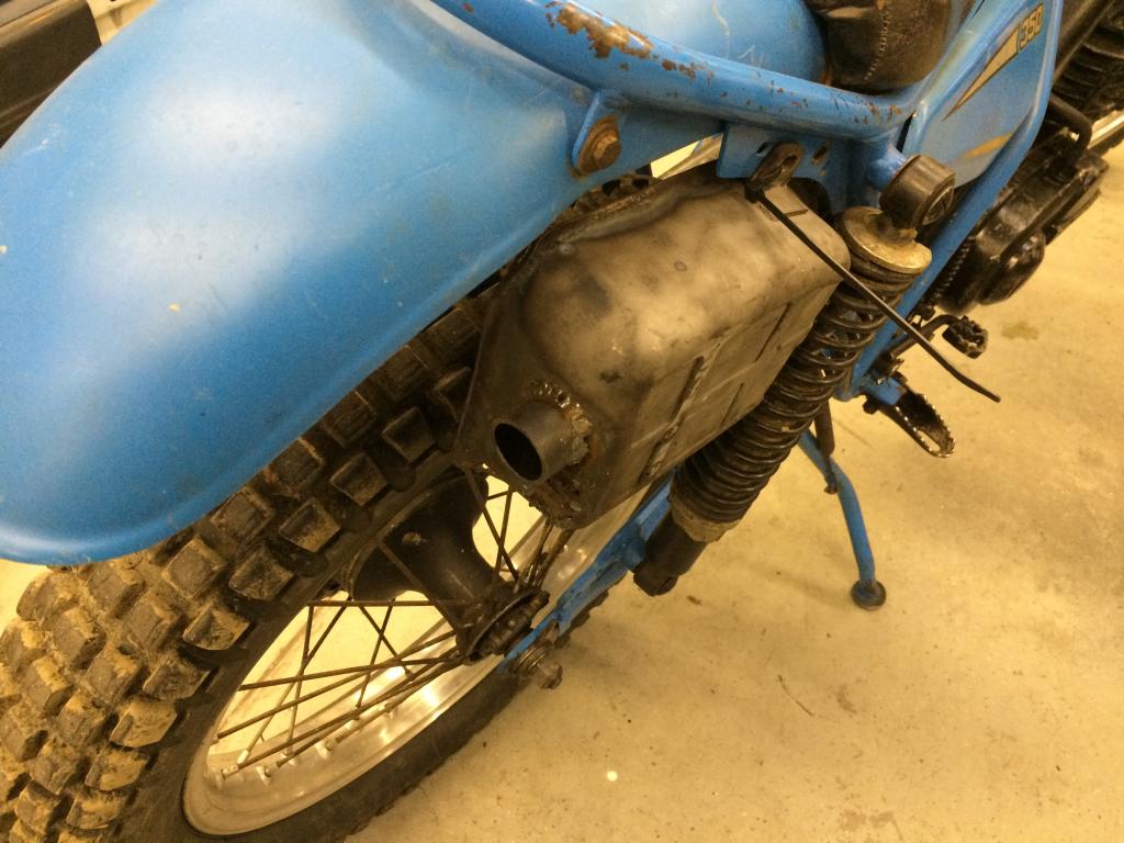

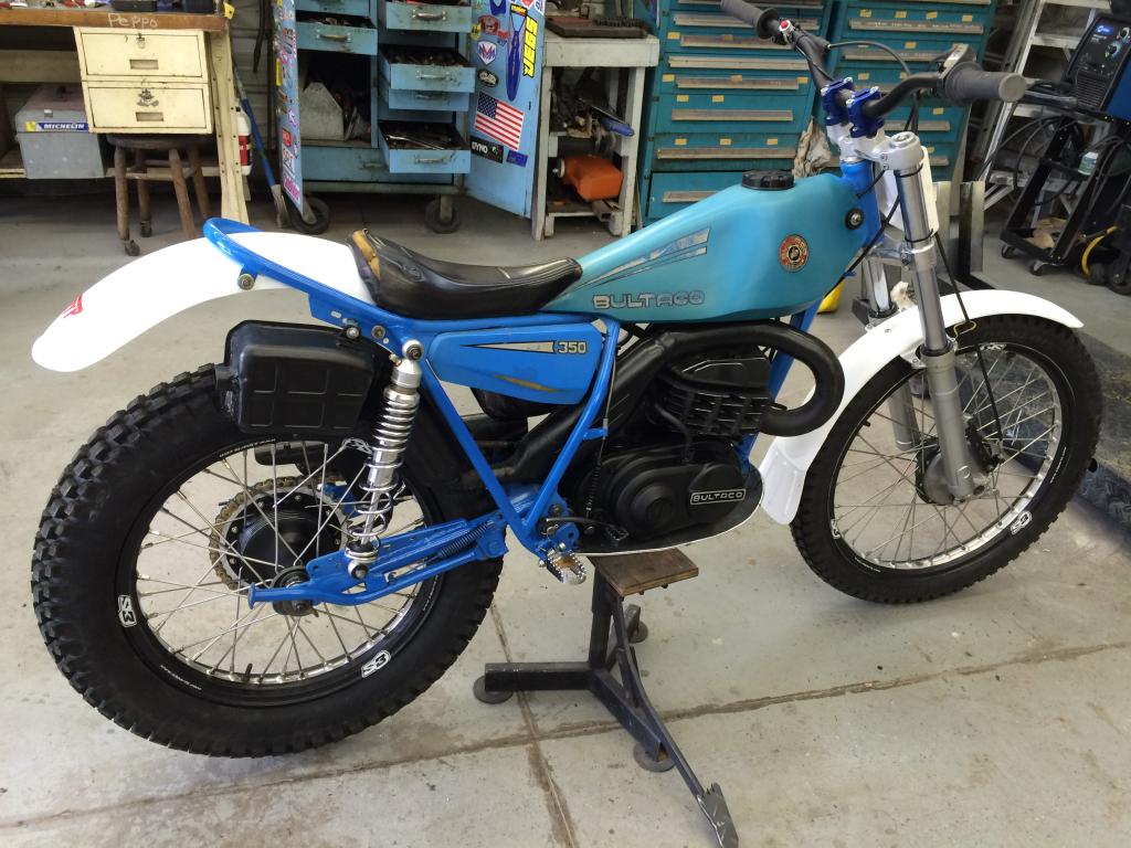

shercosteve Posted September 9, 2016 Report Share Posted September 9, 2016 (edited) The 199A is an excellent bike, I have recently been fixing mine to have a more modern feel. The few items that gave me the most improvement was to move the foot pegs back and down about 1/1/2 inches, I have also installed the OZO adjustable rear shocks which are simply amazing that are sold thru Inmotion. The best performance mods Ive found is to switch from the 350 flywheel to a 250 flywheel, it still has the tractor like pull and the zip of a modernish bike. Ive also switched to a flat slide OKO carb that works very well. I have also repacked my mid muffler and reworked the silencer to a Team Puma mod, which is basically cutting the muffler open removing the mouse trap design on one side, replacing it perforated steel and packing, then removing the twin tip exhaust and replacing it with one one inch diameter outlet...the muffler mod is also a must. I have also switched out the complete front end with one from a 2004 Sherco including triple clamps which changes the rake alot and makes it turn more like a modern. If anyone is interested in my mods I'd be glad to email pictures, especially the muffler which seems to be a secret. Items in the future to test is fiber clutch plates and electronic ignition. I really enjoy riding mine, almost more than riding modern bikes anymore. Im also using s3 triple clamps and fat bars. In the final picture shows some of my muffler mods, I removed the mouse trap, replaced it with perforated steel and packing, on the outside Ive removed the twin tips and replaced it with one 1 inch dia tip, the exhaust is a huge improvement to crisp throttle response. Edited September 9, 2016 by shercosteve 5 Quote Link to comment Share on other sites More sharing options...

axulsuv Posted September 10, 2016 Report Share Posted September 10, 2016 The 199A is an excellent bike, I have recently been fixing mine to have a more modern feel. The few items that gave me the most improvement was to move the foot pegs back and down about 1/1/2 inches, I have also installed the OZO adjustable rear shocks which are simply amazing that are sold thru Inmotion. The best performance mods Ive found is to switch from the 350 flywheel to a 250 flywheel, it still has the tractor like pull and the zip of a modernish bike. Ive also switched to a flat slide OKO carb that works very well. I have also repacked my mid muffler and reworked the silencer to a Team Puma mod, which is basically cutting the muffler open removing the mouse trap design on one side, replacing it perforated steel and packing, then removing the twin tip exhaust and replacing it with one one inch diameter outlet...the muffler mod is also a must. I have also switched out the complete front end with one from a 2004 Sherco including triple clamps which changes the rake alot and makes it turn more like a modern. If anyone is interested in my mods I'd be glad to email pictures, especially the muffler which seems to be a secret. Items in the future to test is fiber clutch plates and electronic ignition. I really enjoy riding mine, almost more than riding modern bikes anymore. Im also using s3 triple clamps and fat bars. IMG_2590.JPGIMG_2591.JPG In the final picture shows some of my muffler mods, I removed the mouse trap, replaced it with perforated steel and packing, on the outside Ive removed the twin tips and replaced it with one 1 inch dia tip, the exhaust is a huge improvement to crisp throttle response. Now that I like ! 1 Quote Link to comment Share on other sites More sharing options...

motovita Posted September 12, 2016 Report Share Posted September 12, 2016 The 199A is an excellent bike, I have recently been fixing mine to have a more modern feel. The few items that gave me the most improvement was to move the foot pegs back and down about 1/1/2 inches, I have also installed the OZO adjustable rear shocks which are simply amazing that are sold thru Inmotion. The best performance mods Ive found is to switch from the 350 flywheel to a 250 flywheel, it still has the tractor like pull and the zip of a modernish bike. Ive also switched to a flat slide OKO carb that works very well. I have also repacked my mid muffler and reworked the silencer to a Team Puma mod, which is basically cutting the muffler open removing the mouse trap design on one side, replacing it perforated steel and packing, then removing the twin tip exhaust and replacing it with one one inch diameter outlet...the muffler mod is also a must. I have also switched out the complete front end with one from a 2004 Sherco including triple clamps which changes the rake alot and makes it turn more like a modern. If anyone is interested in my mods I'd be glad to email pictures, especially the muffler which seems to be a secret. Items in the future to test is fiber clutch plates and electronic ignition. I really enjoy riding mine, almost more than riding modern bikes anymore. Im also using s3 triple clamps and fat bars. IMG_2590.JPGIMG_2591.JPG In the final picture shows some of my muffler mods, I removed the mouse trap, replaced it with perforated steel and packing, on the outside Ive removed the twin tips and replaced it with one 1 inch dia tip, the exhaust is a huge improvement to crisp throttle response. Did you change the ignition flywheel, or the right side flywheel? Quote Link to comment Share on other sites More sharing options...
