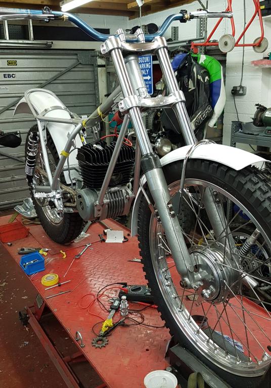

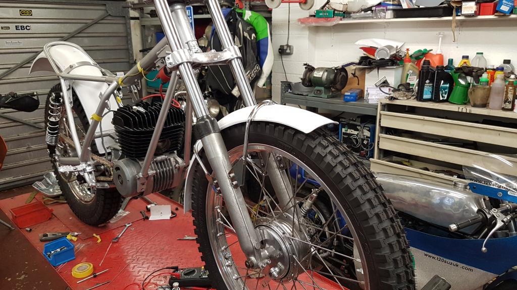

t20racerman Posted October 1, 2016 Report Share Posted October 1, 2016 Hi all Thanks for your help so far with my TR77 restoration. Today I got the top end on, the timing done, a spark, and most of the parts left ready to bolt on (waiting for a pushrod oilseal and the paintwork to come back). I'm sure that I'll be asking for more help, but here is the bike as of tonight. :-) 3 Quote Link to comment Share on other sites More sharing options...
christianmoller Posted October 1, 2016 Report Share Posted October 1, 2016 (edited) As new /christian BTW.what bike to the right,suzuki something..... Edited October 1, 2016 by christianmoller Quote Link to comment Share on other sites More sharing options...
trialsrfun Posted October 1, 2016 Report Share Posted October 1, 2016 (edited) Great job of the TR77, the Suzuki racer looks interesting too. Edited October 1, 2016 by trialsrfun Quote Link to comment Share on other sites More sharing options...

trialsrfun Posted October 1, 2016 Report Share Posted October 1, 2016 (edited) Thank you for the link, that will provide some interesting reading. Does the TR77 have shorter fork stanchions fitted, they do not appear to protrude through the upper yoke as do the normal type. Edited October 1, 2016 by trialsrfun Quote Link to comment Share on other sites More sharing options...
t20racerman Posted October 1, 2016 Author Report Share Posted October 1, 2016 On 10/1/2016 at 8:21 PM, trialsrfun said: Does the TR77 have shorter fork stanchions fitted, they do not appear to protrude through the upper yoke as do the normal type. I'm not sure about that. I've no experience whatsoever of these bikes. I have heard though that you should drop the forks through the yokes, but until you reminded me, I'd forgotten that. I'd better drop them through a bit! :-) Quote Link to comment Share on other sites More sharing options...
trialsrfun Posted October 2, 2016 Report Share Posted October 2, 2016 On 10/1/2016 at 9:32 PM, t20racerman said: I'm not sure about that. I've no experience whatsoever of these bikes. I have heard though that you should drop the forks through the yokes, but until you reminded me, I'd forgotten that. I'd better drop them through a bit! :-)No need to if you have the shorter forks fitted, the ones on my TR77 are the longer type so need to be set lower.If the spindle centre to top measurement is around 29"-30" then the forks are short ones, those on my bike measure 32" with 2" above the yoke. 1 Quote Link to comment Share on other sites More sharing options...
