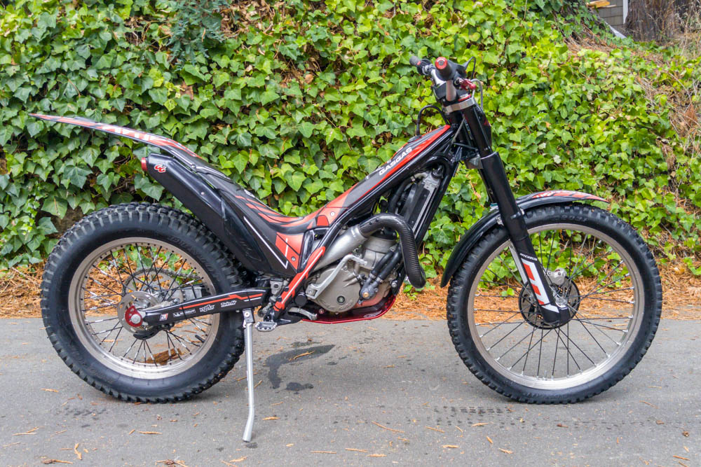

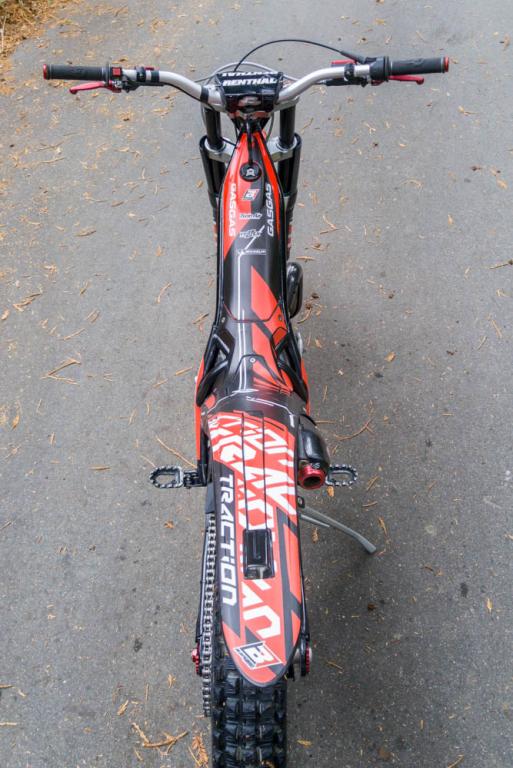

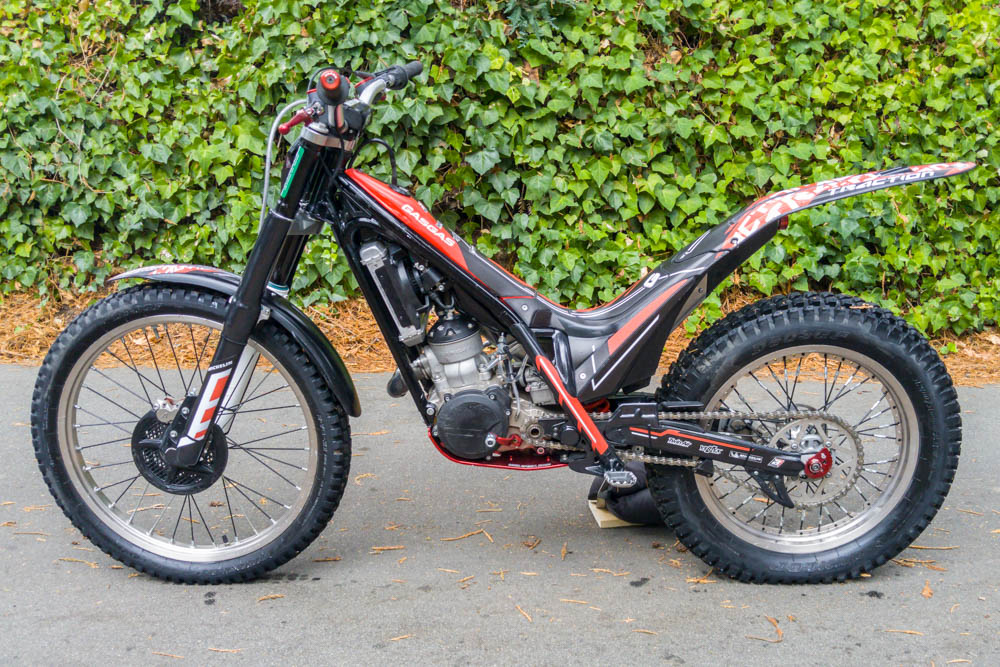

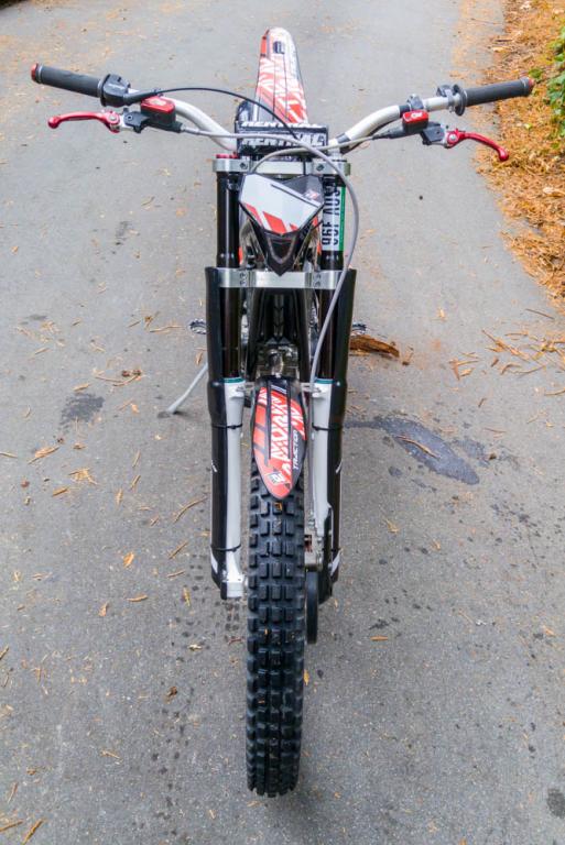

I bought a used 2013 TXT Pro a few weeks ago from a fellow down in Southern California (I am located in Norther CA).  The bike had clearly seen some action, with some dings on the frame, fork tube, fork lowers, etc.  but all in all the price was fair (it had a "Green Sticker" which is golden here as it allows you to ride year round).
After close inspection I found that one of the lower frame tabs was cracked, so I decided to take the bike apart, get the tab welded and while I was at it, get the dings filled (welding) and get the frame, swing arm and forks lowers powder coated.
In the process of taking the bike apart, I found that ALL the bearing in the rear suspension were shot (pressure washing I guess since this bike was a dry weather bike), the bash plate was pretty flattened out, the fork bushing where scratched, the water pump drain bolt was smashed, and a few other minor problems.  So I order a bunch of spare parts (including some suspension springs to match my weight, bunch of Jitsie guards, new bask plate, etc...) while the frame was being attended by my powder coater.
Once I got all the parts, it took me a few days to put it all back together, and once done, I was surprised to see that it started second kick (I didn't open the engine tho, still plenty of compression).
Went out for a ride today and it's miles better than my Scorpa four stroke!!!  I need to refine the carb settings, new rear brake pads, but otherwise... I think I am going to enjoy it.
Here are a few photos.
