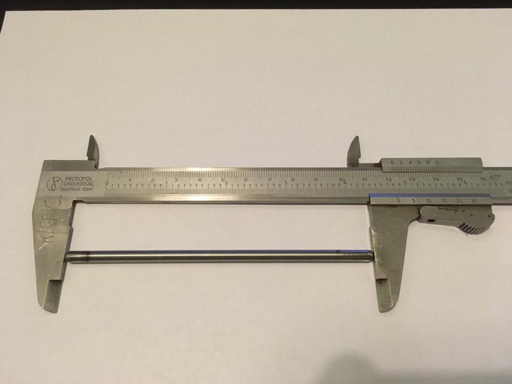

contiki Posted October 11, 2016 Report Share Posted October 11, 2016 there's a long story assiciated with this question, I'll skip that. can anyone tell me how long that straight pushrod is supposed to be? i had my bike apart to figure out why the clutch dragged, and the ball bearing was missing. I had one here, put it where it belongs, and now the clutch slips. I have the cable disconnected, and the cam/lever thing on the case is barely touching the pushrod. I'm wondering now if someone put a longer rod in there and left the ball out on purpose. Quote Link to comment Share on other sites More sharing options...
ourian Posted October 11, 2016 Report Share Posted October 11, 2016 There's a slight amount of parallax on the photo but this one measures 62.55mm Quote Link to comment Share on other sites More sharing options...
contiki Posted October 11, 2016 Author Report Share Posted October 11, 2016 (edited) thanks very much. can you get a measurement on the other as well? Edited October 11, 2016 by contiki Quote Link to comment Share on other sites More sharing options...
ourian Posted October 11, 2016 Report Share Posted October 11, 2016 The straight one is 122.4mm Quote Link to comment Share on other sites More sharing options...
contiki Posted October 11, 2016 Author Report Share Posted October 11, 2016 excellent. thanks twice. Quote Link to comment Share on other sites More sharing options...
