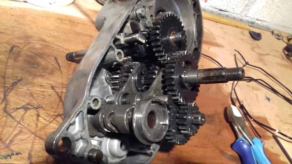

netley Posted October 12, 2016 Report Share Posted October 12, 2016 I have the cases apart in my Sherpa 350t 191 and have been told to have the gearbox in the left hand case so I thought I'd put it back together without the crank to keep it all together. Long story short I end up with a mixture of cogs in a heap. I have assembled it the way it seems to "want" to go together but the images I have are very poor so I have no idea if it is right. I still have to swap the mains bearings over so I have photographed it and will dis-assemble before tackling the bearings. Anyone know of a good account of how it goes back together ? Cheers Neil 1 Quote Link to comment Share on other sites More sharing options...

bullylover Posted October 12, 2016 Report Share Posted October 12, 2016 Hi Netley. That looks correct. It is a bit hard to see but if all the selectors line up and it changes gear and gets all the gears then it is correct. As I said before there is a washer on top of the large kickstart gear. The one next to the crankcase. The M199`s and the 199A`s also had one on the clutch shaft on top that top gear as well but the 159`s don`t so I`m not sure it the 191`s also have that one. Graham. 2 Quote Link to comment Share on other sites More sharing options...

netley Posted October 13, 2016 Author Report Share Posted October 13, 2016 I'm pretty sure this is right and it selects all the gears. 3 Quote Link to comment Share on other sites More sharing options...
