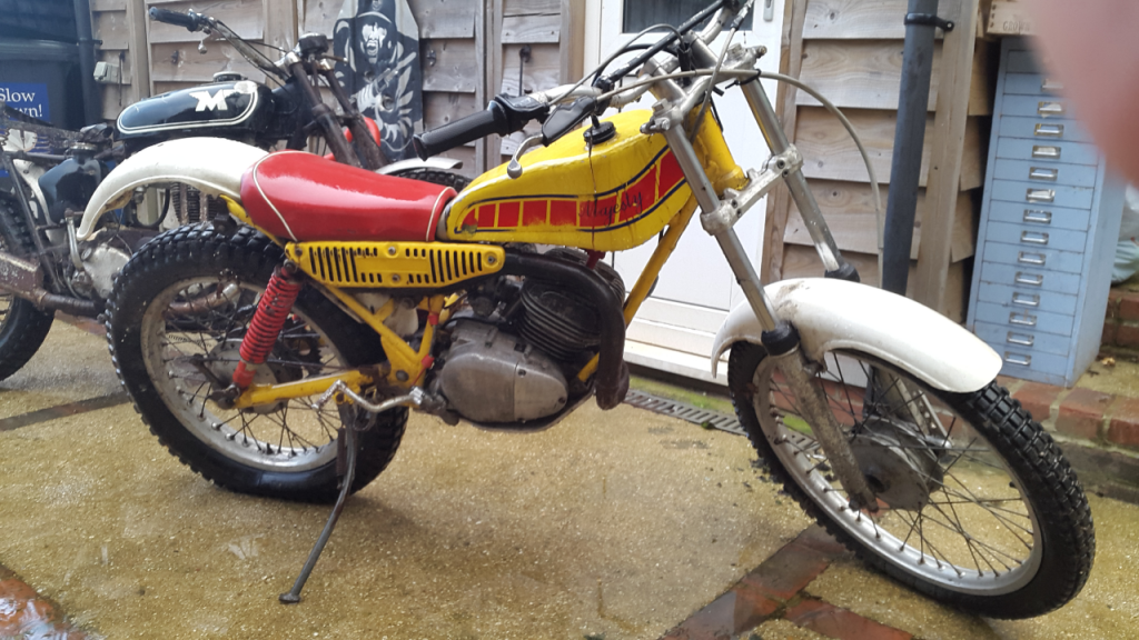

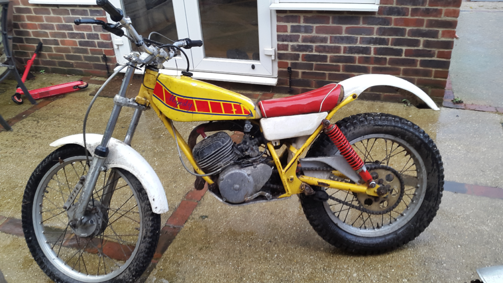

mjc477 Posted October 17, 2016 Report Share Posted October 17, 2016 (edited) I picked this up a few hours ago... I don't think it's a majesty but does have some obvious parts fitted The rain does believe it or not make it look better Anyways over to you guys... Edited April 15, 2020 by mjc477 1 Quote Link to comment Share on other sites More sharing options...
johnnyboxer Posted October 17, 2016 Report Share Posted October 17, 2016 Looks like a Godden framed bike, maybe painted yellow Definitely an Adult 175 frame, the front downtubes are kinked back towards the barrel (Mini Majesty Youth Frames, had straight downtubes) Tank is right and even has the opaque rear plastic tank cup holder still, as is the oil pump cover and the majesty chainguard Looks right to me, you have a good one 1 Quote Link to comment Share on other sites More sharing options...

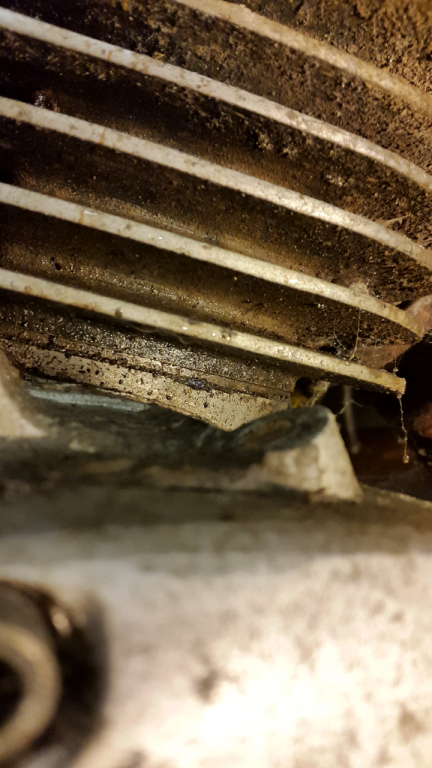

scorpa250 Posted October 17, 2016 Report Share Posted October 17, 2016 That is a genuine majesty , have a look on the base gasket area and see if there is a spacer about 5mm thick if so 200 majesty . Well done dont see many original ones anymore . 1 Quote Link to comment Share on other sites More sharing options...

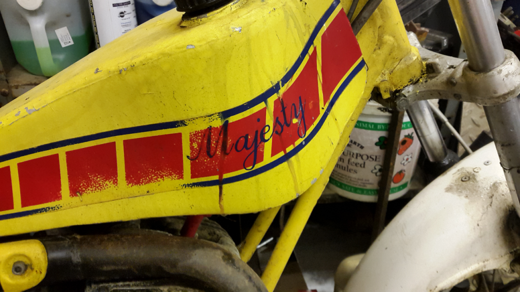

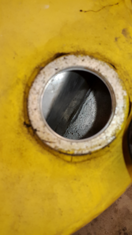

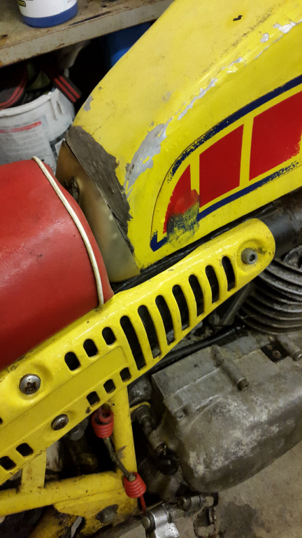

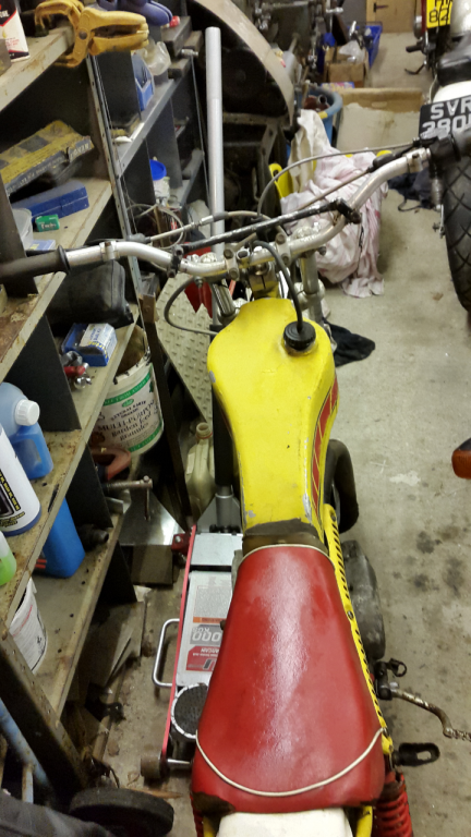

mjc477 Posted October 17, 2016 Author Report Share Posted October 17, 2016 (edited) Well that did surprise me... Any other way of identifying it..any particular parts...frame numbers etc... It is pretty ropey the rain made it look fairly ok Good news is engine is free and smooth with good comp.. Clutch is jammed solid but Ive not looked any further than pulling the lever.. I must say it's quite a nice looking bike.. I will try and get some better pics soon.. Here's a few in the garage Edited April 15, 2020 by mjc477 1 Quote Link to comment Share on other sites More sharing options...

trialsrfun Posted October 18, 2016 Report Share Posted October 18, 2016 (edited) Definitely a Godden framed Yamaha Majesty 175 or 200 I have one the same. The first ones had modded standard frames then at different times yellow, red and chrome finish. Swing arm appears to be the Majesty made one, these were slightly longer than the modified Yamaha type which were also fitted to many Majesty bikes. Do not know where John Shirt had them chromed but the powder coated ones were finished at a powder coaters on the industrial estate at Leek which has recently closed down. Superb little bike, looks in good enough condition to give an end to end service then go and ride it. Edited October 18, 2016 by trialsrfun Quote Link to comment Share on other sites More sharing options...

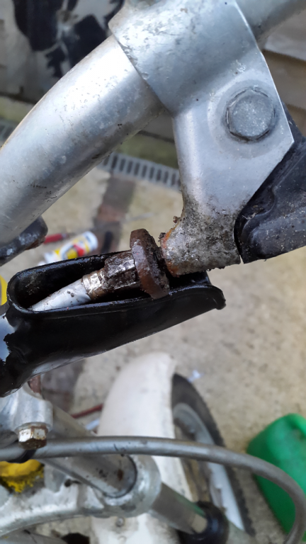

mjc477 Posted October 18, 2016 Author Report Share Posted October 18, 2016 Well tonight I looked at the clutch..the lever end was solid...a bit of plus gas and it freed of...it's abit rough but at least it now works.. I also took the carb off and that was a right mess but everything finally cleaned up... Fresh fuel and fluids..etc Half a dozen kicks and it's running sweet as a nut.. A couple of questions The kick start lever will only return half way and is sloppy from this point..I guess the return spring has either come out of its stay or worse broke....it has a very short bungee on it which was obviously put on it to hold it up...so has been like it for some time And also should it have a rear silencer ....it looks like the pipe is kicked in to the tyre ...i have heard that was done sometimes to blast any loose mud off .... And next question... Any idea on model and year on this ... Thanks ks again Quote Link to comment Share on other sites More sharing options...
