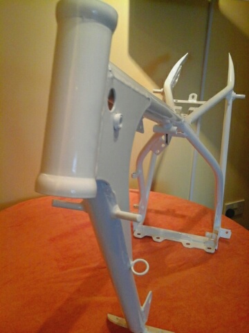

pschrauber Posted October 26, 2016 Report Share Posted October 26, 2016 Pic's from the powder coated frame: 2 Quote Link to comment Share on other sites More sharing options...
