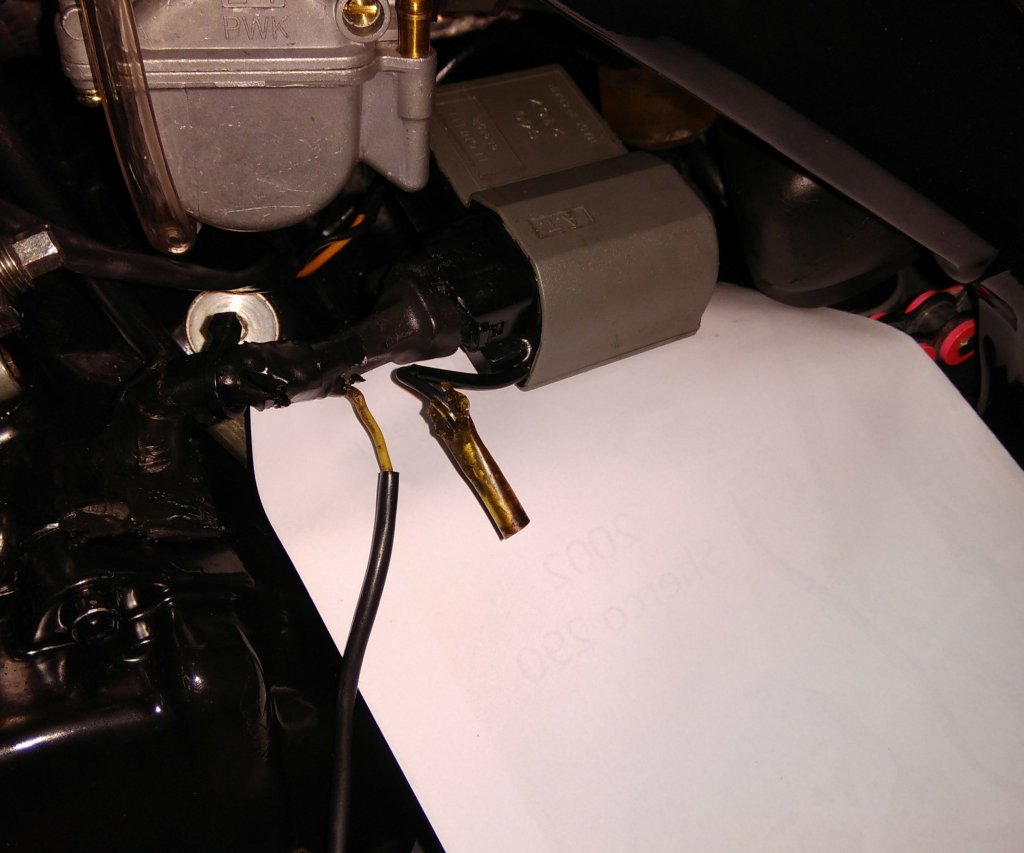

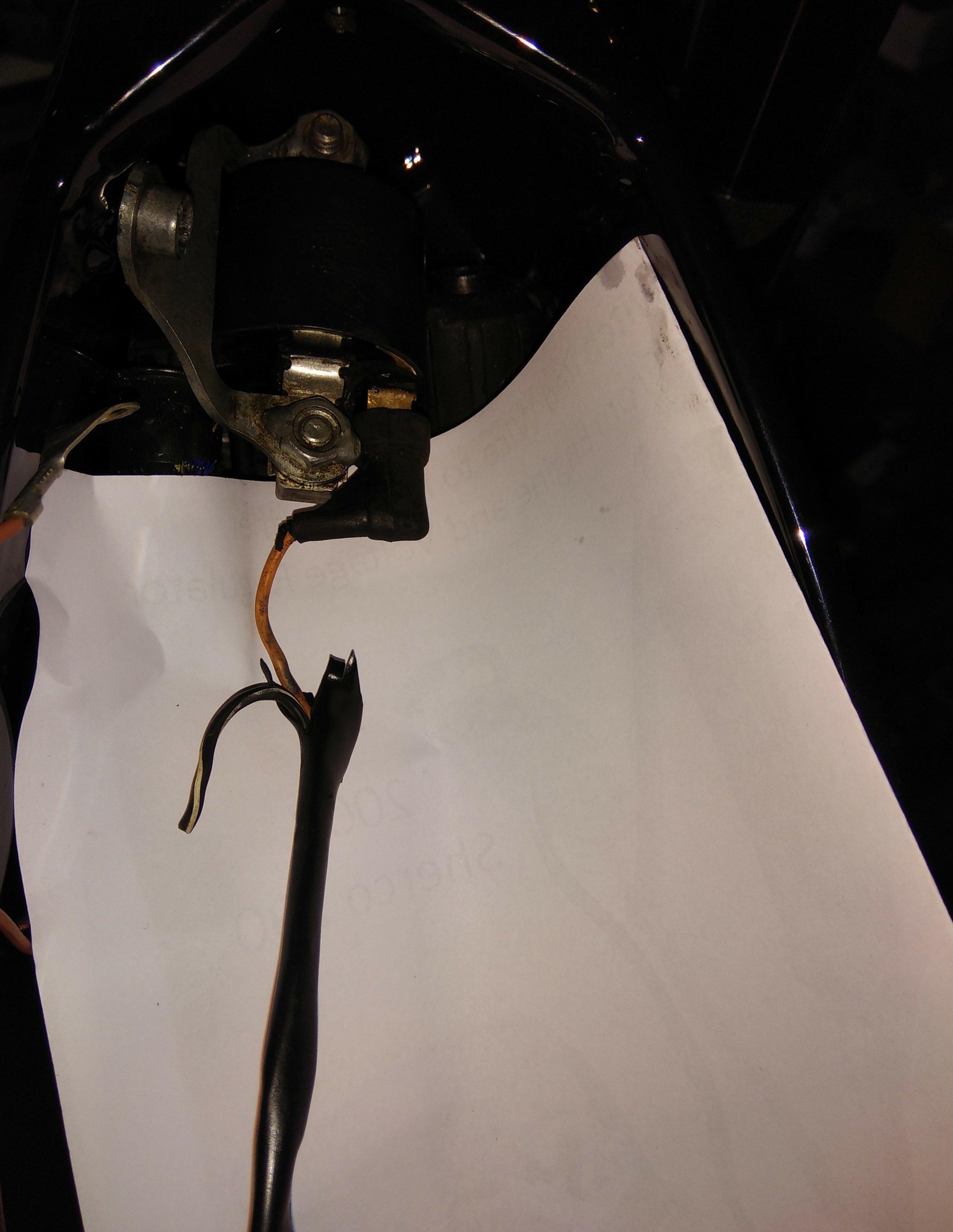

proper Posted February 3, 2019 Author Report Share Posted February 3, 2019 Got a question, hope someone is able to answer it: The 320 has a seperate CDI and iginition coil (bobine). On most 2T those two are combined in one unit. The CDI is located right above the front sprocket. It has one black lead coming out. (picture 1) The ignition coil is located near the headset. From the CDI runs an orange wire to the ignition coil, together with a black wire with white striping. (picrure 2) I've added some white background for contrast in the pictures. I'm wondering if the latter black wire should be used to connect the engine kill switch to. Or should the lower black wire on the CDI be used? Quote Link to comment Share on other sites More sharing options...

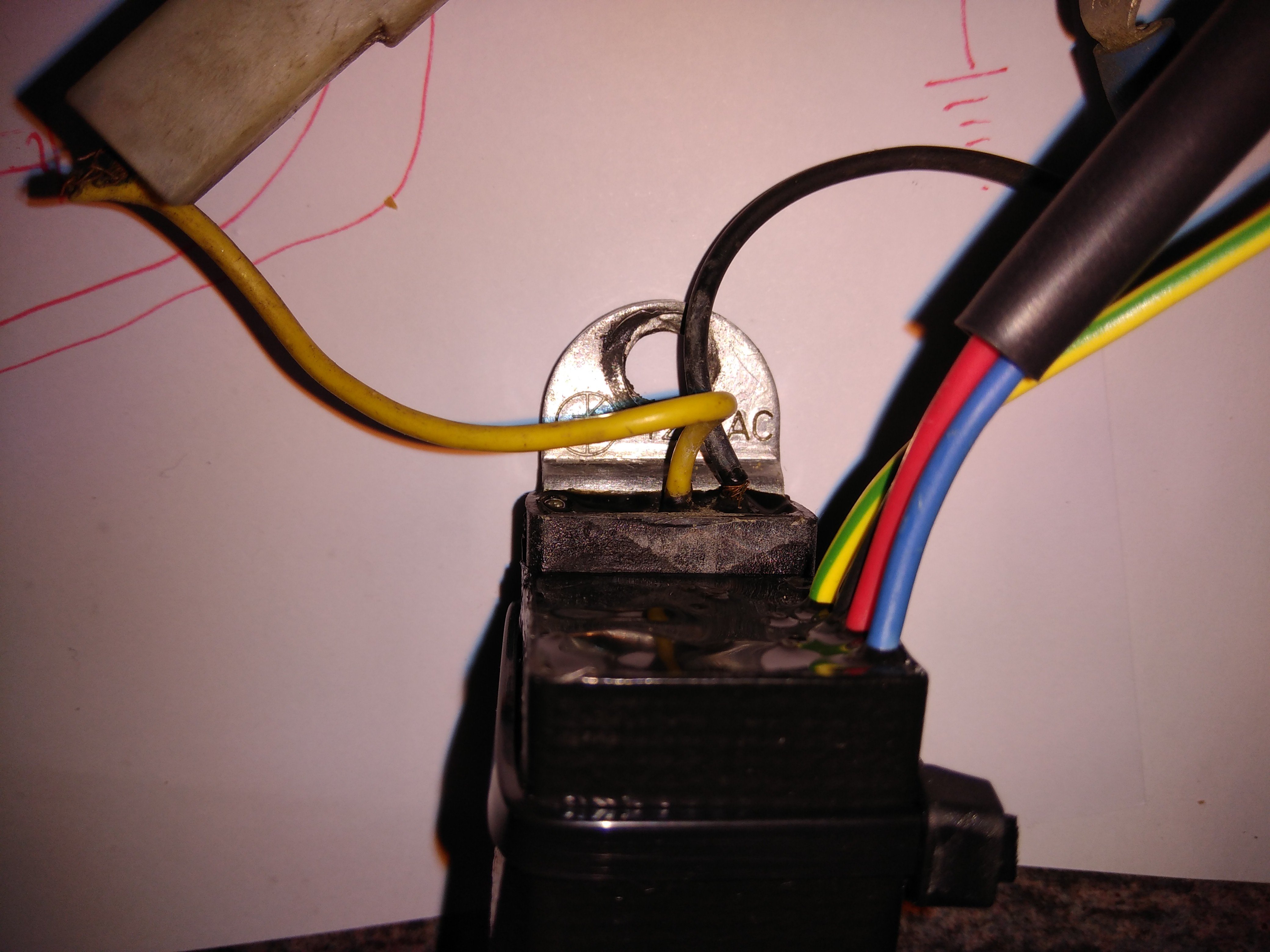

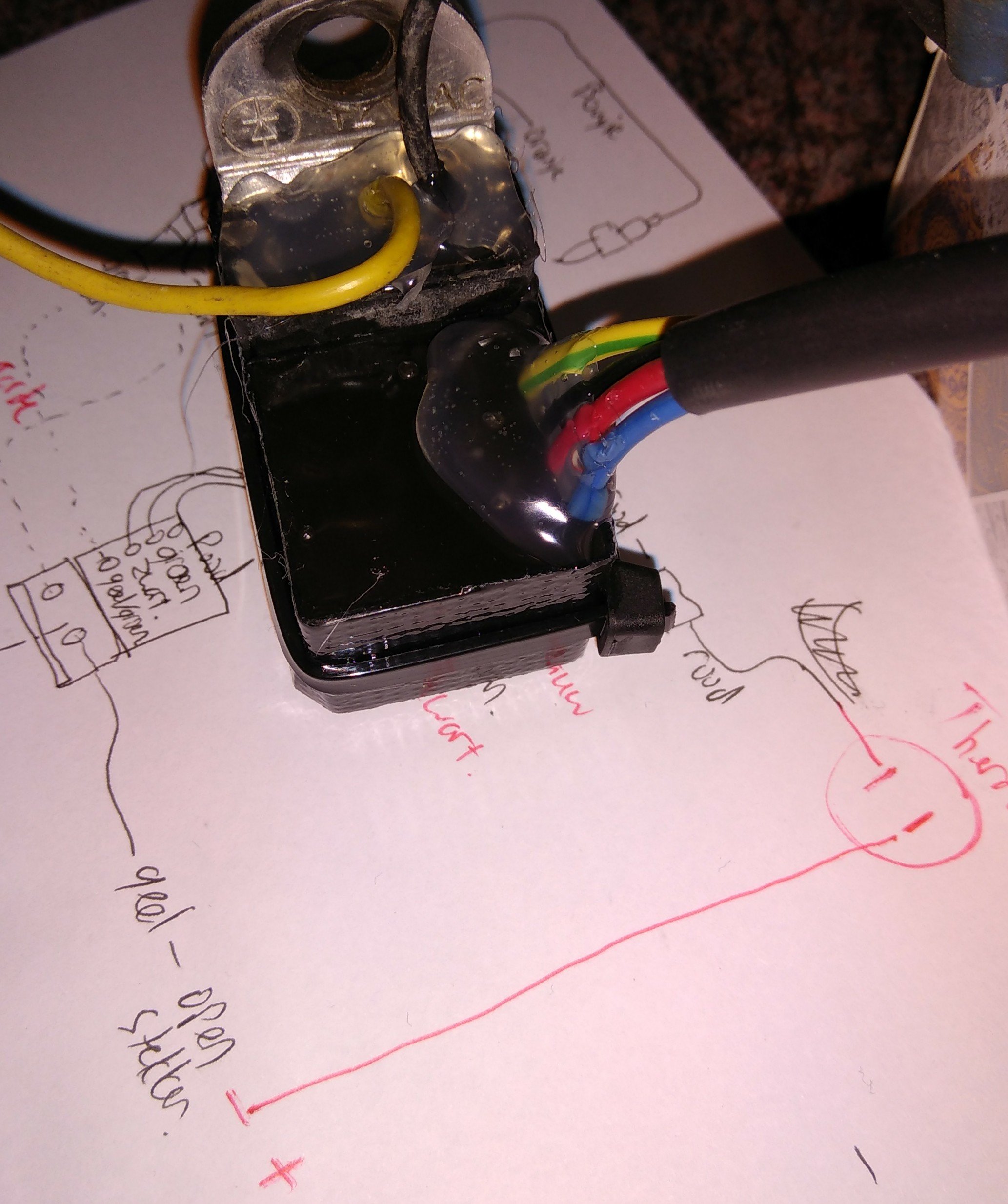

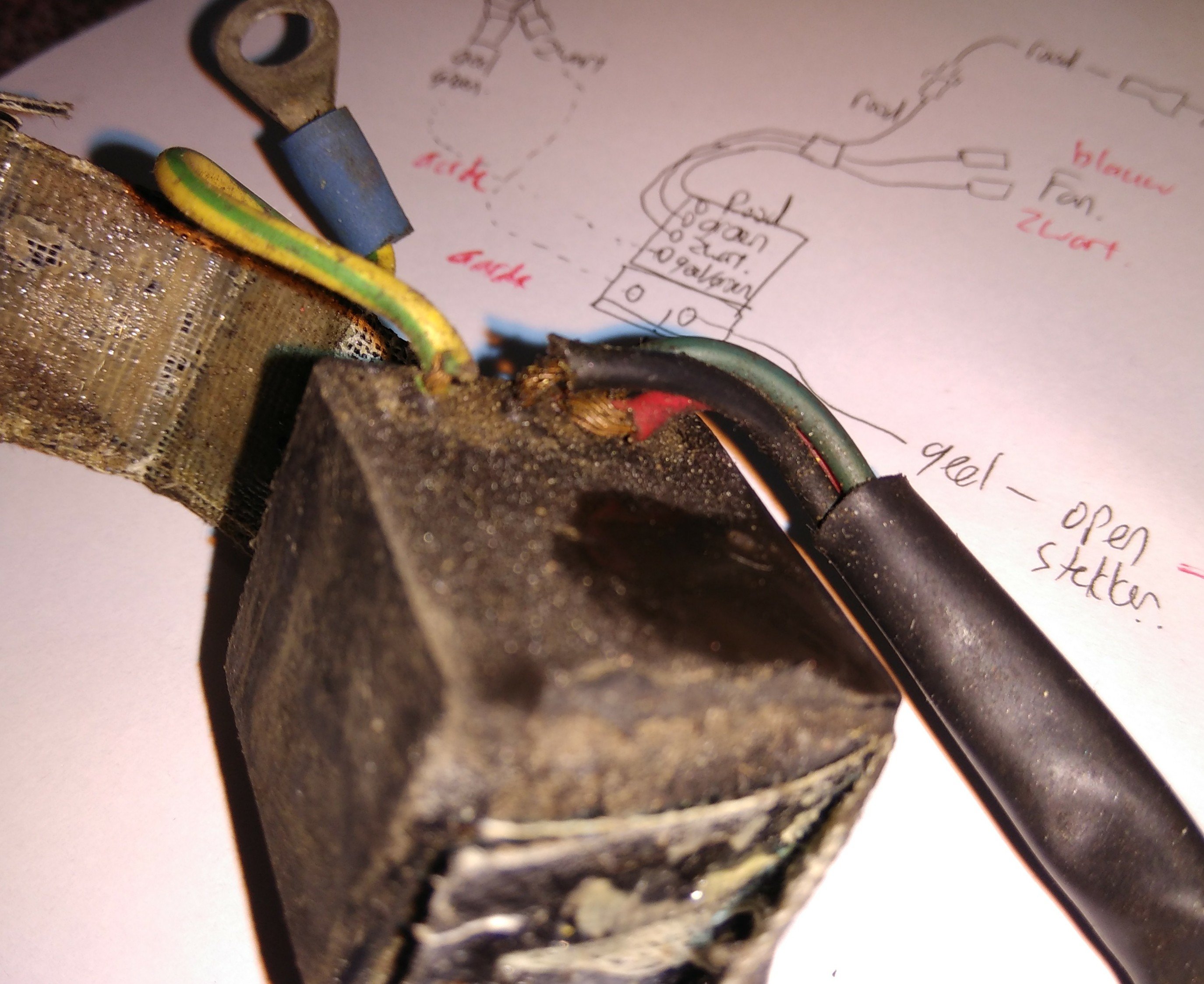

proper Posted February 3, 2019 Author Report Share Posted February 3, 2019 The rectifier wires were in bad shape, with bare copper strands close to each other. The regulator also had signs of wire degration. I decided to replace the rectifier, and try to save the regulator. Added a big blob of hotglue around all wires coming out of the unit to prevent future damage. Quote Link to comment Share on other sites More sharing options...

proper Posted February 3, 2019 Author Report Share Posted February 3, 2019 So, I'm still looking for the function of the shown black wire with white striping. My local Sherco dealer thinks it's ground. Quote Link to comment Share on other sites More sharing options...
2stroke4stroke Posted February 3, 2019 Report Share Posted February 3, 2019 I think that would accord with convention. Quote Link to comment Share on other sites More sharing options...
proper Posted February 4, 2019 Author Report Share Posted February 4, 2019 Thanks! Changed the pilot jet from 38 to 42. Will fire her up again after work. Quote Link to comment Share on other sites More sharing options...

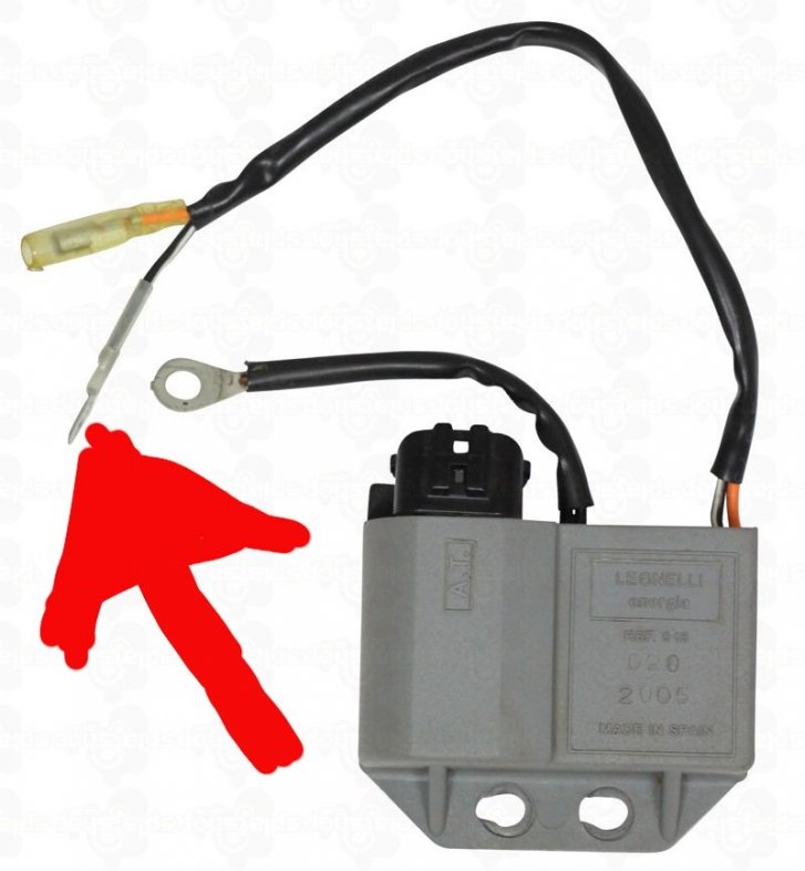

proper Posted February 4, 2019 Author Report Share Posted February 4, 2019 Talked to Chris from Splatshop, who confirmed my gutt feeling the black/white cable is there for the kill switch, which happens to coincide with the length of the existing engine kill harness. Problem solved. And I also learned that the short black wire protruding from the CDI gives ignition mapping 2 when shorted to ground. Nice chaps @splatshop Quote Link to comment Share on other sites More sharing options...
