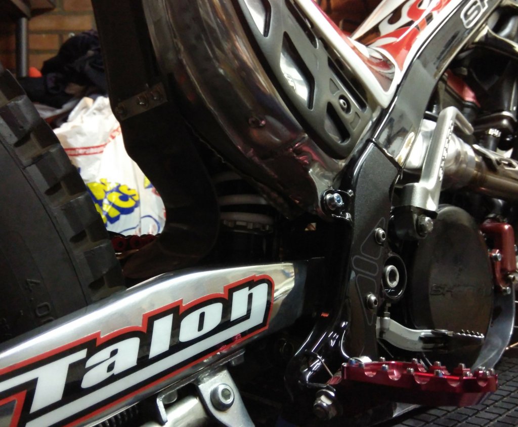

proper Posted February 9, 2019 Author Report Share Posted February 9, 2019 Finished! 1 Quote Link to comment Share on other sites More sharing options...
proper Posted February 9, 2019 Author Report Share Posted February 9, 2019 Will take some shots outside tomorrow. Quote Link to comment Share on other sites More sharing options...

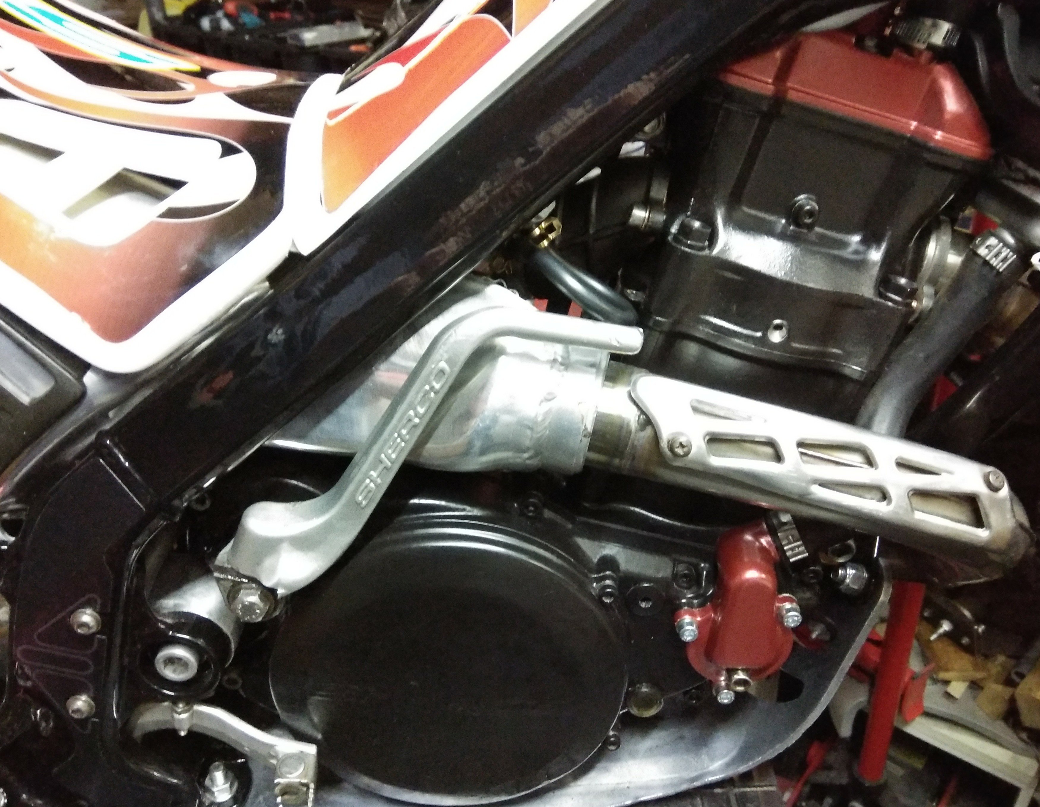

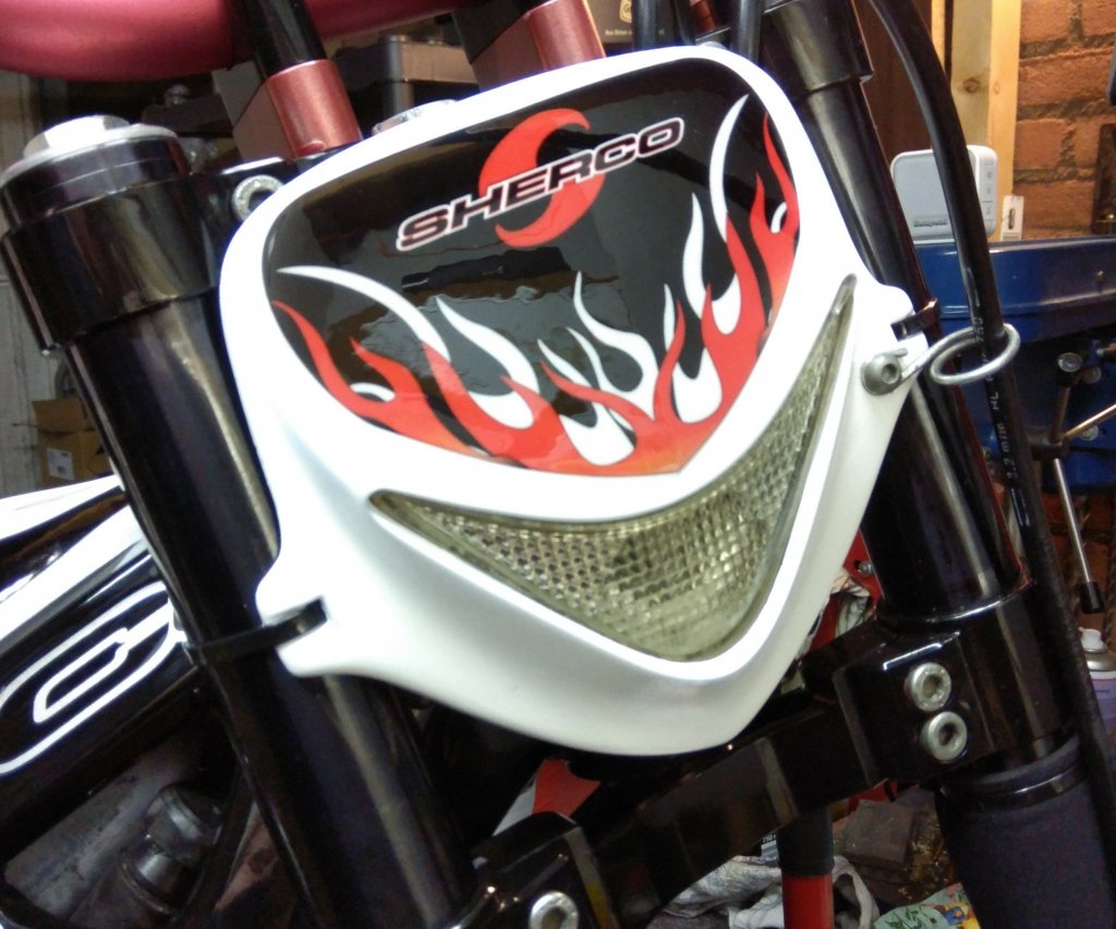

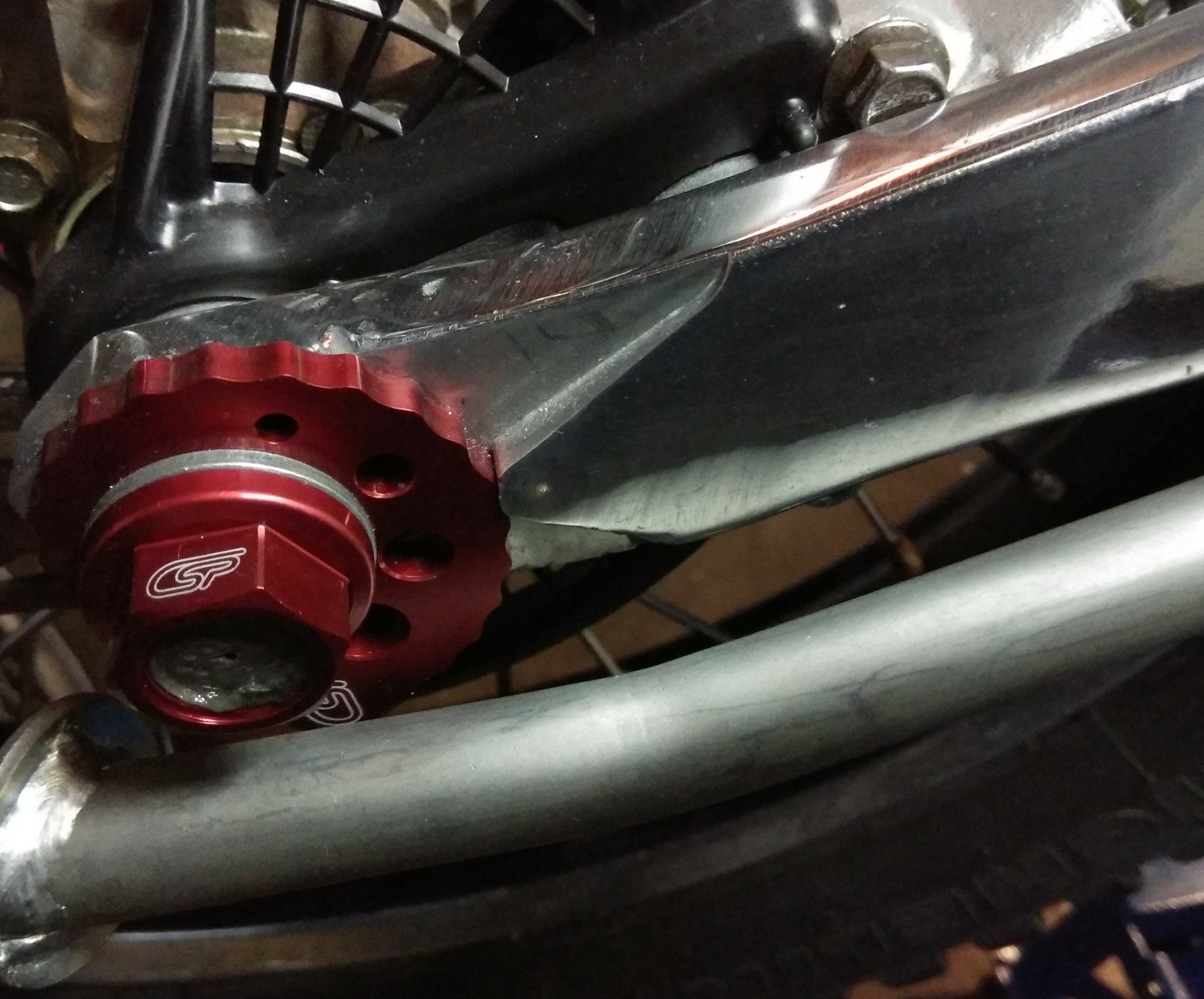

proper Posted February 10, 2019 Author Report Share Posted February 10, 2019 Some quick shots between the rainstorms. Quote Link to comment Share on other sites More sharing options...
proper Posted February 10, 2019 Author Report Share Posted February 10, 2019 Reached my file size limit. Some more: 2 Quote Link to comment Share on other sites More sharing options...
