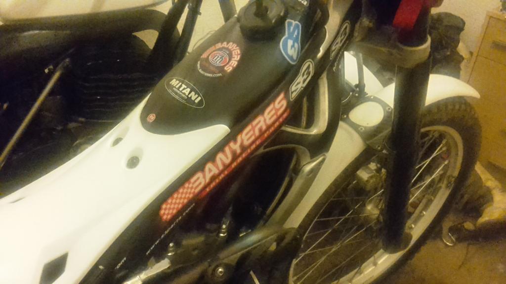

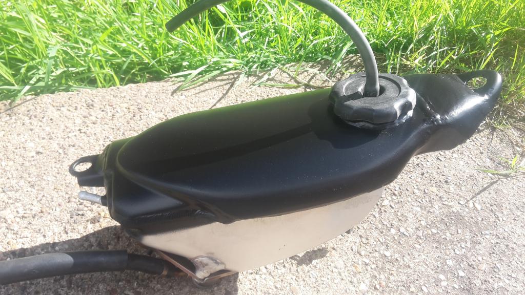

toneh Posted November 4, 2016 Report Share Posted November 4, 2016 Yes I have , I used 1,2 was gonna go thinner but wanted little more strength Quote Link to comment Share on other sites More sharing options...
toneh Posted November 4, 2016 Report Share Posted November 4, 2016 Im a welder fabricator by trade so cost me nothing otherwise I wouldn't have bothered 2 Quote Link to comment Share on other sites More sharing options...
toneh Posted November 4, 2016 Report Share Posted November 4, 2016 (edited) It's lighter than standard , looks far better than standard in my opinion And regards fuel capacity the loss is minimal I fill up no more than anyone else and certainly less than my old 300 gas gas And if I do a trial with any distance id put my auxiliary hebo tank on And best of all it was free Edited November 4, 2016 by toneh 1 Quote Link to comment Share on other sites More sharing options...

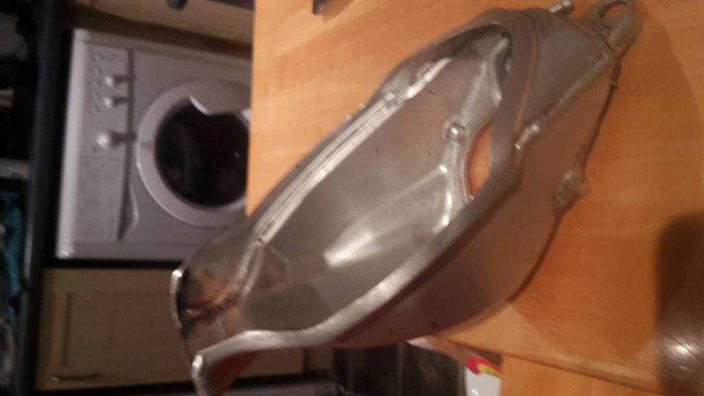

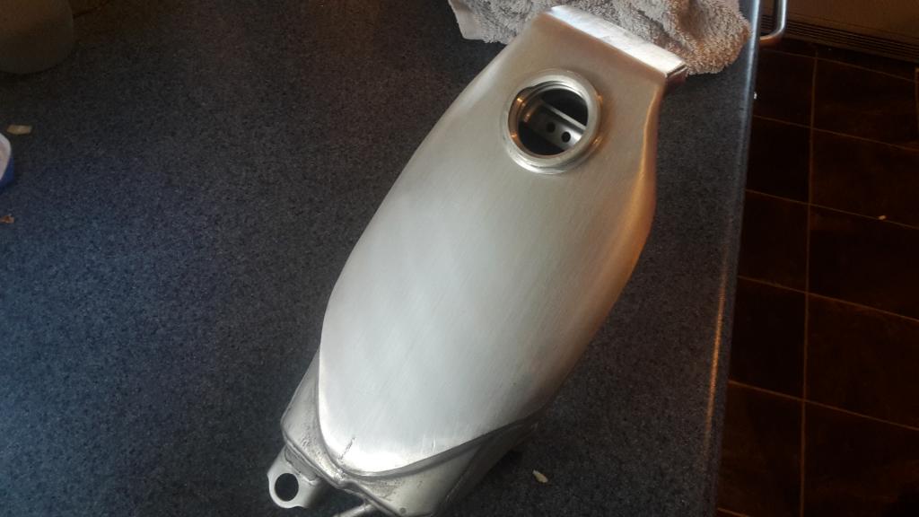

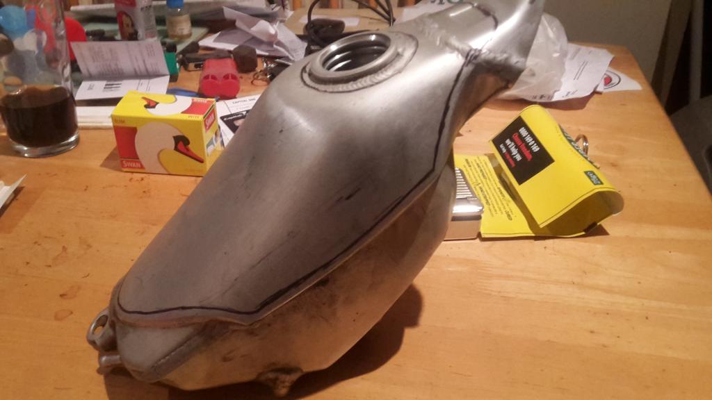

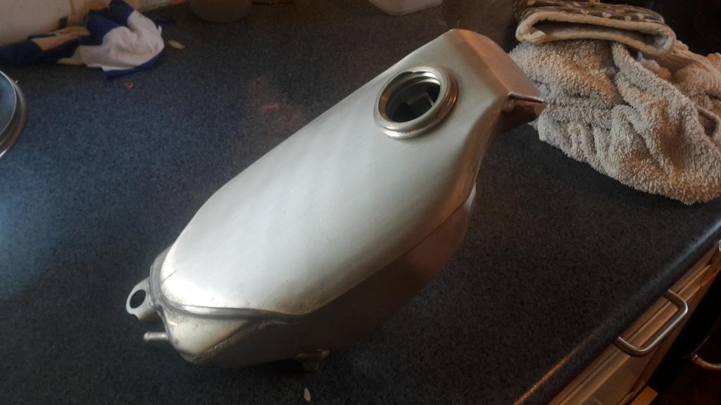

jasehibbs Posted November 4, 2016 Author Report Share Posted November 4, 2016 Wow that looks awesome exactly what I was after, when you say 1.2 was that 1.2mm how did you get the nice rolled edges. Thanks Jason Quote Link to comment Share on other sites More sharing options...
toneh Posted November 4, 2016 Report Share Posted November 4, 2016 Yes 1.2 mm , I rolled the whole top to get the basic curve , and we have got some tiny rollers at work so I just pinched the sides and bent them over Then spent a fair while tapping it round the edges to get a nice fit for welding It is actually a compound curve but not worth stretching because aluminium that thickness is easy to manipulate by hand Quote Link to comment Share on other sites More sharing options...
toneh Posted November 4, 2016 Report Share Posted November 4, 2016 Would have liked to get the top bracket welded on a bit neater but I dropped a clanger and forgot to remove the anodising And got some porosity in it Couldn't be bothered to grind it out and start again But to be honest I've seen some named tanks where the welding is nothing to shout home about Quote Link to comment Share on other sites More sharing options...
toneh Posted November 4, 2016 Report Share Posted November 4, 2016 Oh and you don't actually need to remove the top bracket Just a bit too much haste with the grinder Doh Quote Link to comment Share on other sites More sharing options...
