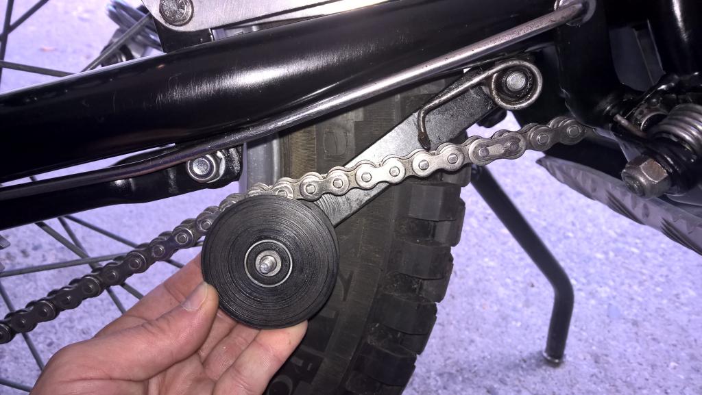

pschrauber Posted November 20, 2016 Report Share Posted November 20, 2016 My Panda still have a roller type chain tensioner and this type is a bit bulkier and too needs maintaince as the roller bearing installed to the roller tensioner wears down depending the weather circumstances. While the slide doesn't need any maintaince beside regularly control and a swap when necessary Quote Link to comment Share on other sites More sharing options...

pschrauber Posted November 20, 2016 Report Share Posted November 20, 2016 See here for all parts of a roller type, as long as the roller is attached near the rim/tire it's at a relatively secure spot, as the roller does have it's height especially when using bearings. Quote Link to comment Share on other sites More sharing options...
