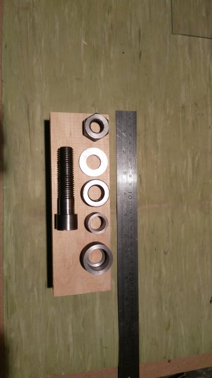

exman Posted February 21, 2017 Author Report Share Posted February 21, 2017 (edited) I did check suspension and found out that four out of six needle bearings were frozen. I had to make bearing puller (overall cost 30$) since it was impossible to press the bearings out of swingarm housing. Had to replace suspension plate, all sbearings and seals, and everything works fine now, but ground clearance remained the same. Herebelow is the photo of the bearing puller (could be used on the dogbone too), and I can make a dimensioned drawing if anybody else like to do it himself. Edited February 21, 2017 by exman photo place by mistake in the middle of text 2 Quote Link to comment Share on other sites More sharing options...
