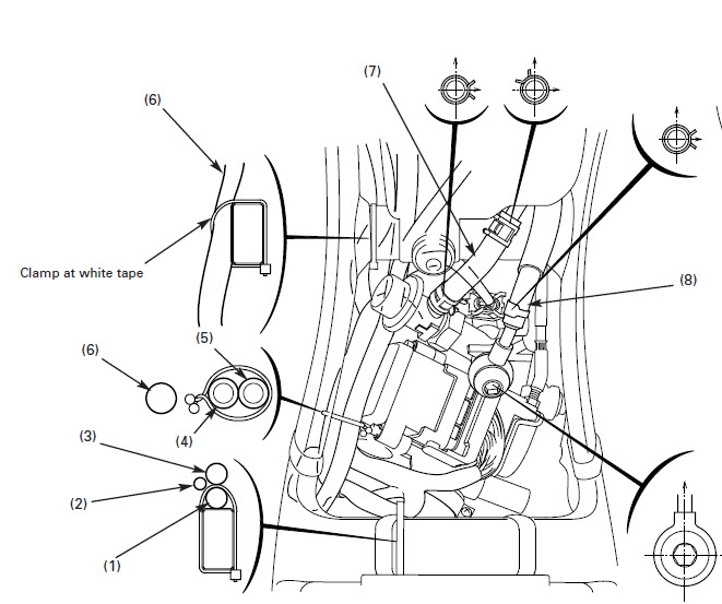

honda_freak Posted December 3, 2016 Report Share Posted December 3, 2016 (edited) What fuel line are you talking about - is the fuel feed hose or perhaps the the fuel return hose !!! Edited December 3, 2016 by honda_freak Quote Link to comment Share on other sites More sharing options...
thall1 Posted December 3, 2016 Author Report Share Posted December 3, 2016 the fuel feed line .....item 8 Quote Link to comment Share on other sites More sharing options...

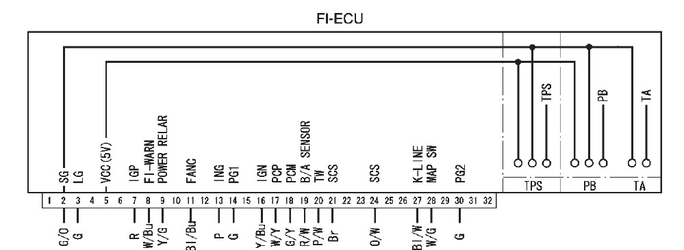

honda_freak Posted December 25, 2016 Report Share Posted December 25, 2016 (edited) As Jonnyc21 already had shown here about to test a capacitor - wouldn't I repeat what he has written other than to say - that the capacitor is very vital part of the battery-less system and without the help of the capacitor during startup is it nearly impossible to start.What I think you should check on your trial-bike has something to do with ECU voltage on terminal pin 5 on the ECU. Without five volt on this terminal 5 wouldn´t the ECU be able to activate the ignition and the fuelpump system properly. Before you make this measurement be very carefull not to bend or break any terminals pins. You could make some extension leads to put in the ECU connector.Remember when you make this mesaurement to put your DMM to record peak value as this voltage are not a steady reading or else you would get a false voltage reading.Based on the result of that test - another test of the flywheel generator coil and recitifier / regulator may be necessary to conduct.BTW is there a consistant blue spark between the sparkplug electrodes !!! Regards Honda_freak Edited December 25, 2016 by honda_freak Quote Link to comment Share on other sites More sharing options...
