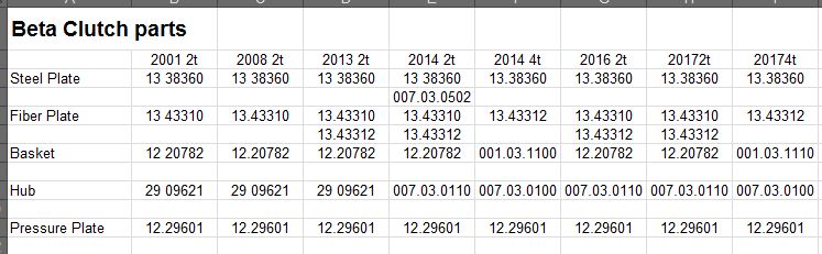

Ah, tracked down interesting data in the parts manual. In 2014 the factory two stroke had two different steel plates. I assume that's what these are. In 2014 there is a new clutch hub number for the 2t bikes except the 125 which still uses the old hub. The pressure plate and basket for the standard 2t has stayed the same for at least a decade. The newer 4 strokes use all six of the thick fiber plates. Where you see the two fiber numbers is where the 4 thin, 2 thick plates are used. Just a guess but the new hub might be slightly deeper to aid the engagement of the steel plate at the top of the stack.
