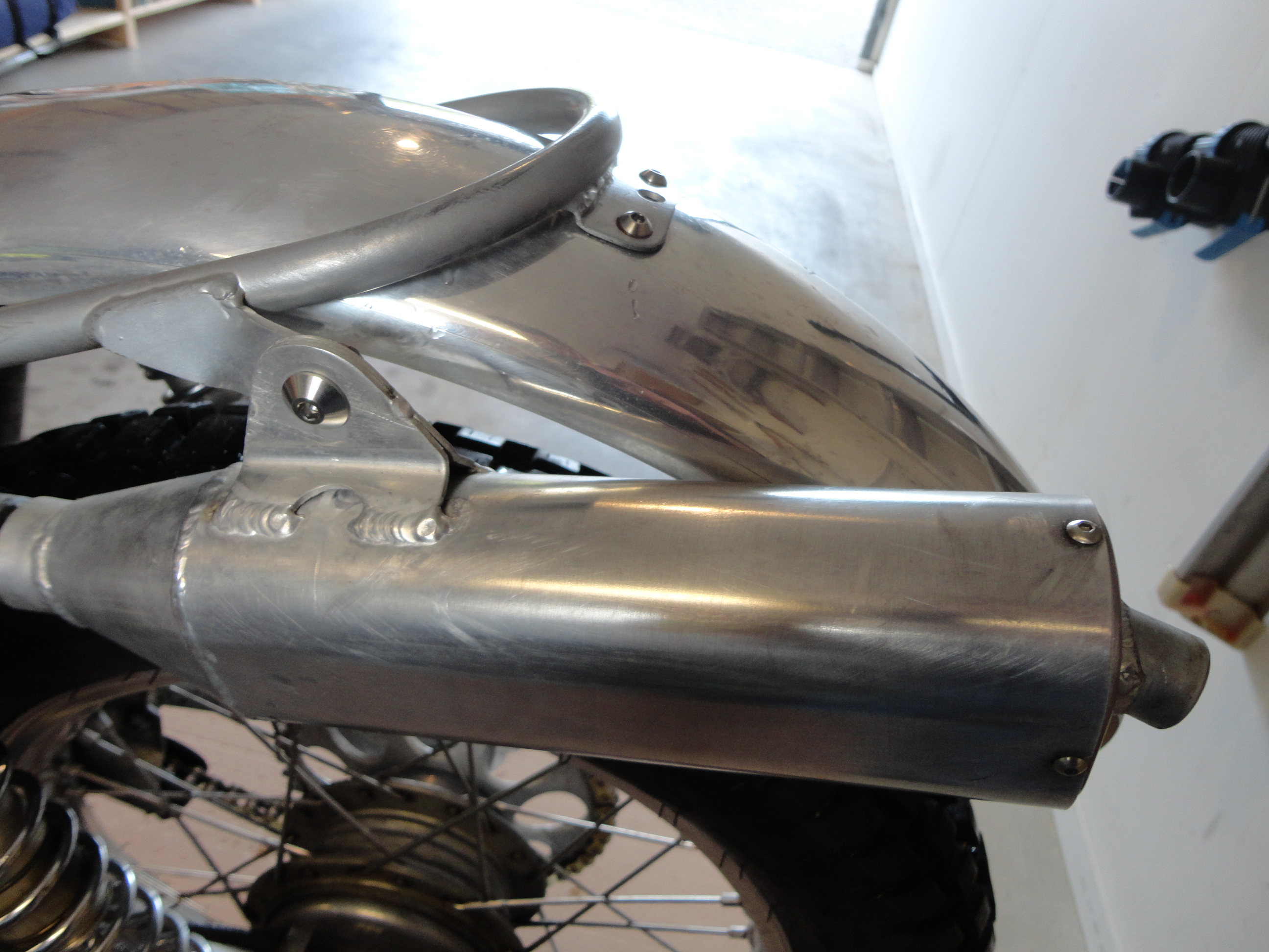

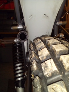

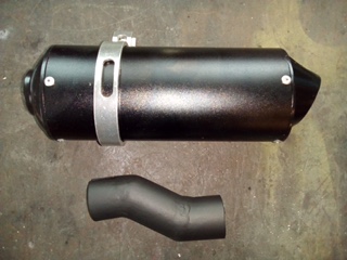

seedoubleyou Posted March 17, 2017 Author Report Share Posted March 17, 2017 I thought I'd let you know how this one ended up. To to begin with the original silencer appeared to be touching the tyre. See below. So I purchased some 38mm mild steel pipe from eBay and welded up an angle. This slipped nicely over the original pipe with a little Dremel work on the inside of the tube. I also invested in a £12 pit bike silencer just to see what it was like. It turned up and didn't look half bad. The bore was also 38mm so an easy fit. I then made a small bracket using a bit of strip from the 2 mudguard mounts to the can strap also provided with the can. Having run the bike insilenced and with the new can there is a big difference which I think will be acceptable 1 Quote Link to comment Share on other sites More sharing options...
