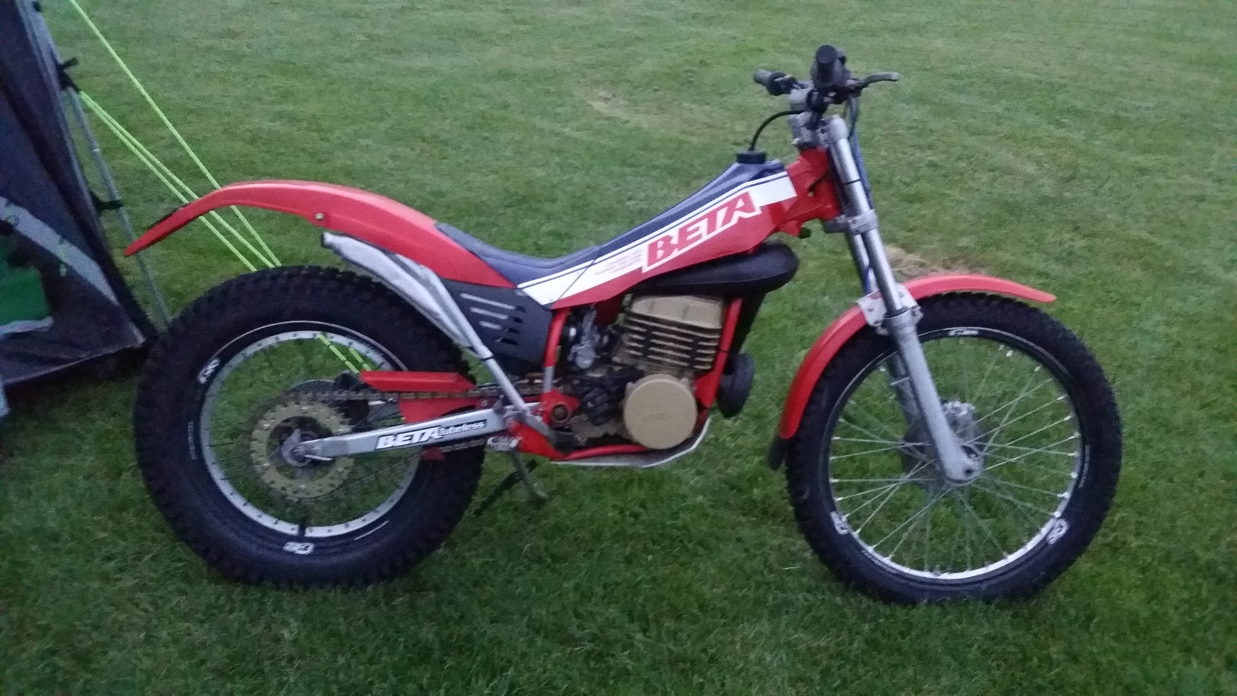

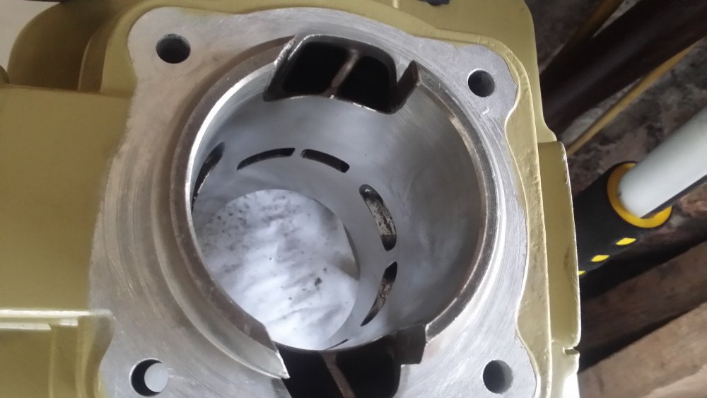

andy walker Posted January 20, 2017 Report Share Posted January 20, 2017 (edited) I experienced this problem when I rebuilt my 260cc TR34, so I sent my barrel and piston down to Lancourts who checked the piston over then plated the barrel to match the original piston, that was over a year ago and the bike is still running sweet with no problems, obviously my piston wasn't to badly worn but it may be another option to look at if your struggling. Edited January 20, 2017 by andy walker Quote Link to comment Share on other sites More sharing options...
pschrauber Posted January 22, 2017 Report Share Posted January 22, 2017 Wasn't it stated in previous threads and posts? There are no pistons available and this sadly hasn't changed in the last three years beside one or two accidental findings at some dealers. Even frequently asking wount cure the problem? 250 - 300 GBP per piston of a run of 10 to 15! that are numbers. As previous mentioned it may be the case that your piston is still reuse able but the cylinder needs an overhaul, but too the opposite can be necessary (the normal case btw.) With a new plating of the cylinder often the con-rod and his bearings are at their end of their lifetime too then these should btw. also been replaced. Get these three main parts checked as with the reasonable amount of money to spent already for one of them it doesn't make sense in the longer run to just replace one instead all three as if one of them fail or got to the end of wear it will effect the others too. I personal had good experience with Woessner from coating (Nikasil), piston forged custom, con rod can be replicated by them too. (found a NOS in France). Woessner did the job very good and priceworthy btw. and you have a guarantee on the three main parts too. Quote Link to comment Share on other sites More sharing options...

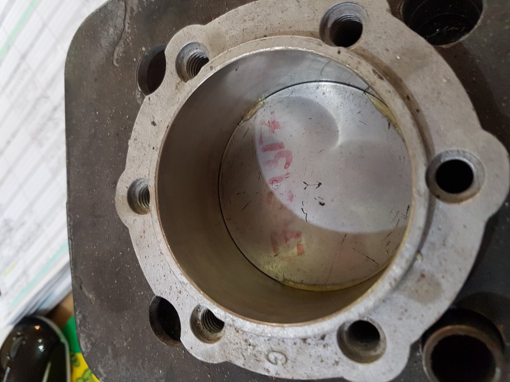

Guest Posted February 7, 2017 Report Share Posted February 7, 2017 Piston. 260cc. I have had one (single). It was NOT cheap but well made. Waiting time also is prohibitive if in a rush! I'm doing another 2 so you may want to get in touch. 1 Quote Link to comment Share on other sites More sharing options...
Guest Posted February 7, 2017 Report Share Posted February 7, 2017 P.s. zero, techno are a no go for dimensions. Quote Link to comment Share on other sites More sharing options...
