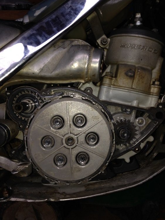

bluegnu Posted February 2, 2017 Author Report Share Posted February 2, 2017 (edited) In the meantime, I'd drained the coolant as I thought it was overheating (there was more than i'd expected to see), but when I drained the oil it was a milky emulsion: So have ordered pump seals and see if that helps. It did seem to be running very hot, fan was intermittent but was coming on and then I got some knocking after a while. Edited February 2, 2017 by bluegnu Quote Link to comment Share on other sites More sharing options...
bluegnu Posted February 2, 2017 Author Report Share Posted February 2, 2017 Also the exhaust has burnt the radiator hose and scorched the cylinder head! Quote Link to comment Share on other sites More sharing options...
