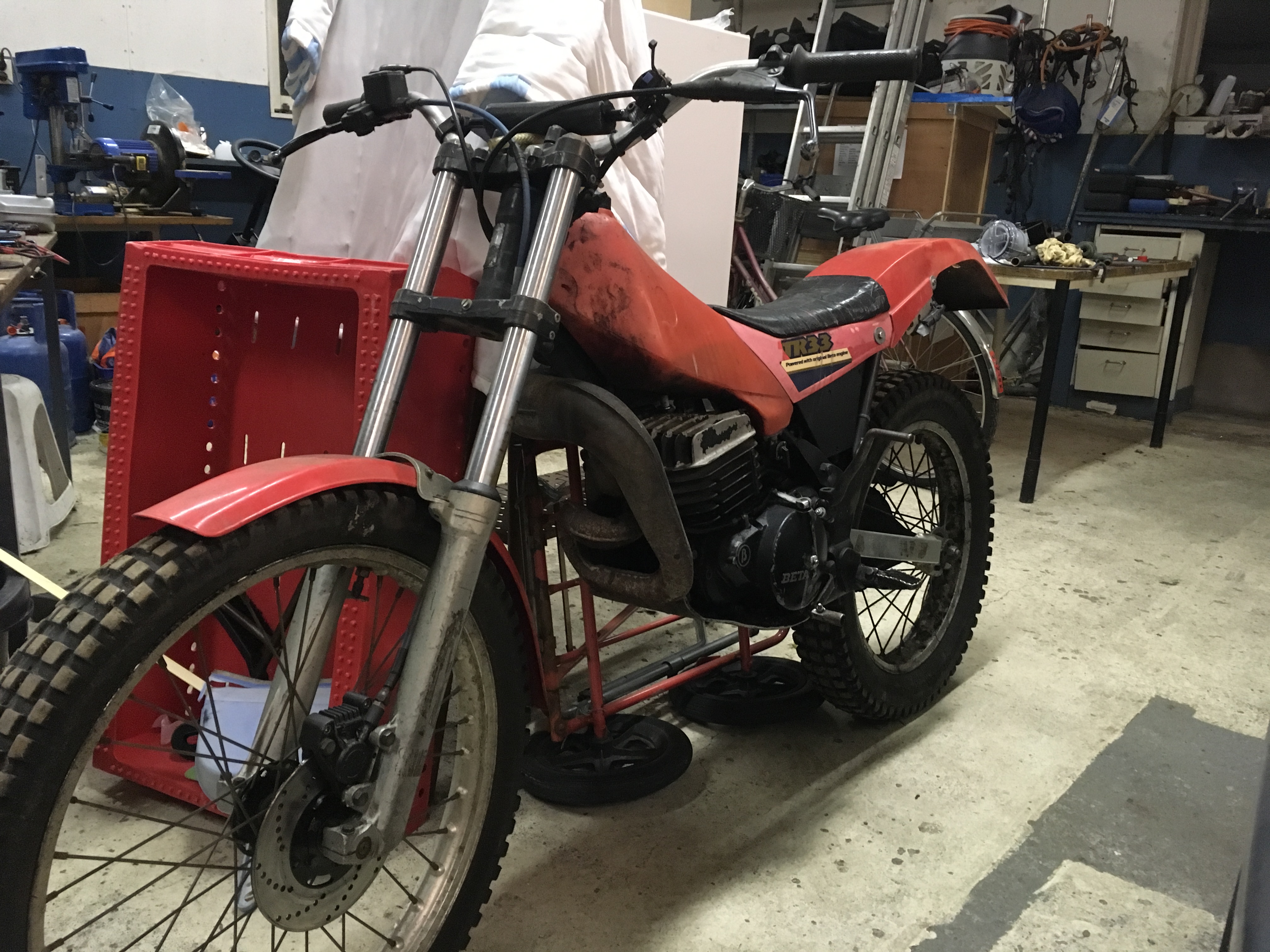

khristi Posted February 8, 2017 Report Share Posted February 8, 2017 (edited) Hello, I'm new here and I have just purchased a Beta TR33, with the 239 cc engine, from 1986. The bike has been stored in a garage for the last five years and we didn't try to start it since the kick start lever was removed. The engine went around fine and compression seemed very good though. I don't even have the bike home yet but when checking it at the sellers place I noticed a few things: 1. The rear suspension had quite slow return. The spring seemed fine but the damper probably needs service. How servicable are those? Nitrogen filled or just oil? 2. The front break needed quite some pumping to build pressure. I didn't see any leaks so I guess this is because the bike has not been used for the last five years. What do you think? 3. The right fork had a small leak. Is there any seals to get or do I have to go for some generic? 4. The clutch didn't disengage the drive entirely but had no noticeable slack either? Ideas? Time for new discs? I will probably have more questions once the bike is in my garage, thanks for now. Edited February 8, 2017 by khristi Quote Link to comment Share on other sites More sharing options...

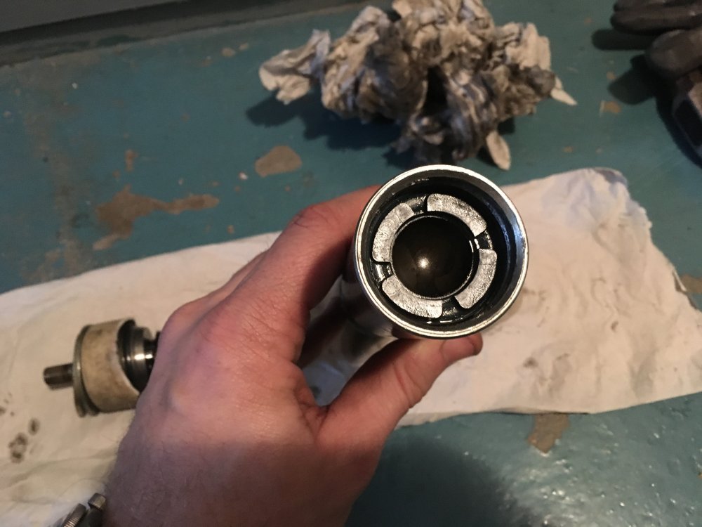

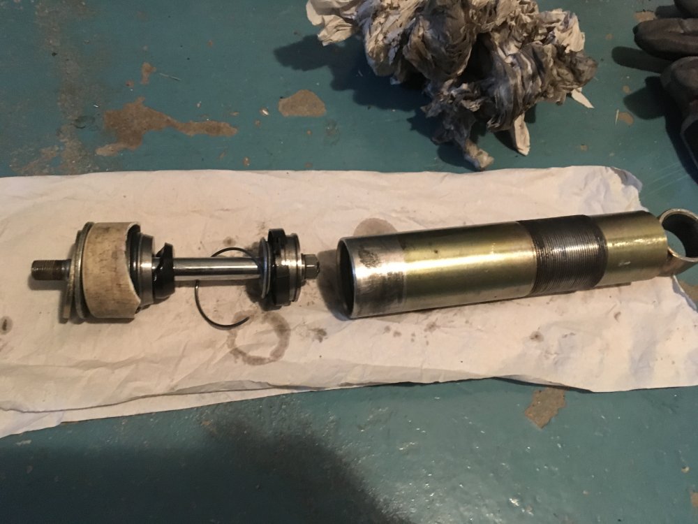

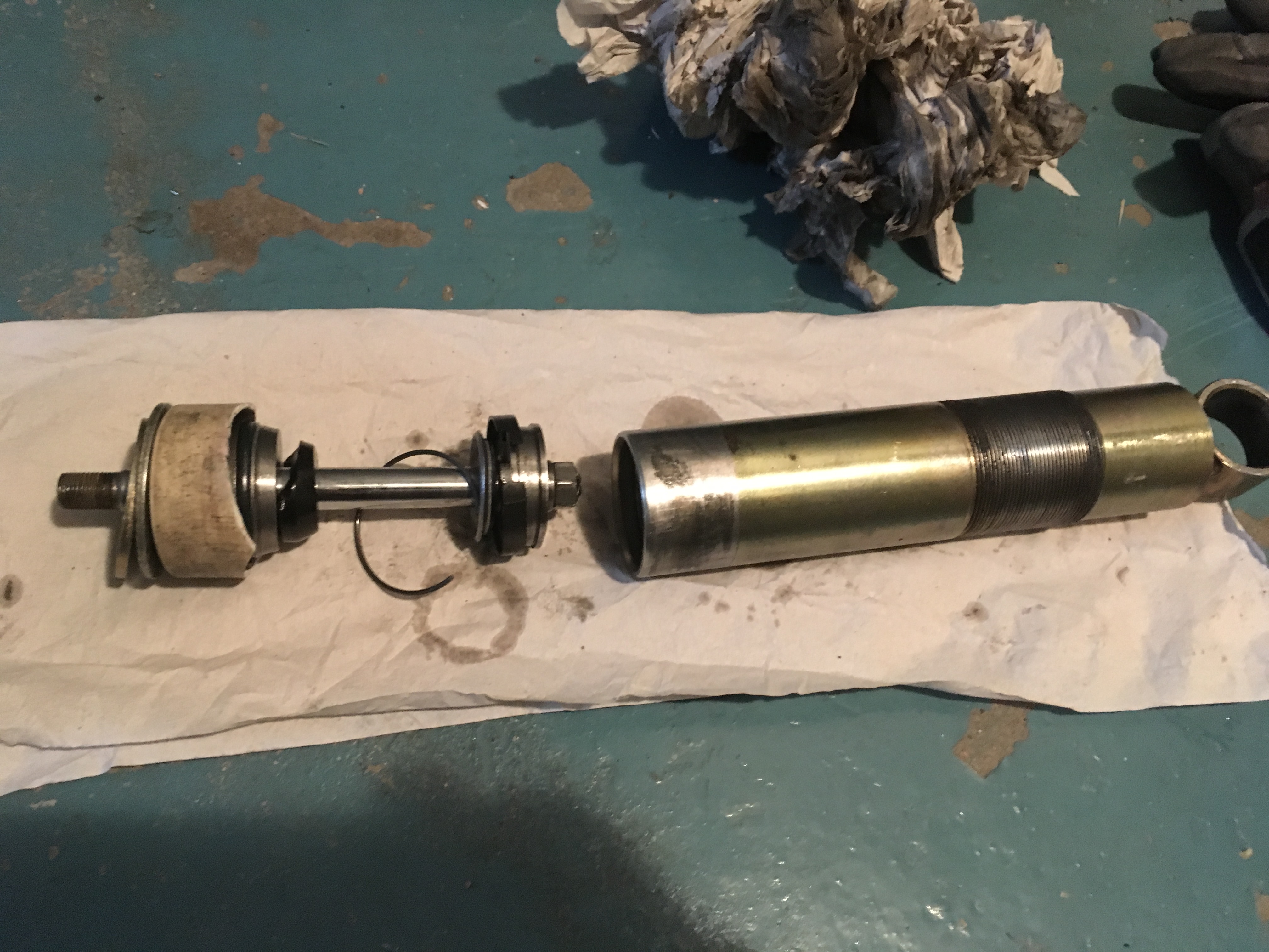

khristi Posted February 20, 2017 Author Report Share Posted February 20, 2017 (edited) I'm not giving up on this one yet. My plan is to ride it like a mix between "slow enduro" and "free in the woods trial", like a cheap version of an Ossa Explorer or similar. I'll hardly be riding any challanging, pure trials with it. The brake is now ok after adding new fluid and purging air. The clutch is ok. The friction discs and the plain discs were almost "glued" together by old sticky oil. Took it apart and cleaned it up and it now engages and releases as supposed (I suppose). Couldn't find a torque value for the clutch spring bolts so I used 12 Nm. Anyone knows? I have new seals for the forks but the dust caps seem unavalable. I guess I just have to use the old ones which seem fine and maybe use neoprene protectors in addition. The rear shock are now in parts. Small pieces of the internal "punch through" rubber had came loose and were jammed in the valve. I accidently spilled most of the oil when I took it apart and I don't know how much oil to add. There is a separate chamber in the tube, I dont know if it's nitrogen filled, air filled or just spring loaded. There is no schrader valve or similar to refill it with (if air or nitrogen) but it's very springy and if gas filled it doesn't leak. Should the oil chamber be entirely filled when gas chamber is fully compressed? There does not seem to be a spec avalable for this shock so whats's generally the idea? When looking on rebuild videos of shocks with external gas bladder they seem to fill fully with oil before adding nitrogen. Edited February 20, 2017 by khristi Quote Link to comment Share on other sites More sharing options...

khristi Posted February 27, 2017 Author Report Share Posted February 27, 2017 The white plastic is just the outer dust cap. Inside it there's a smaller o-ring type dust cap toward the stem. The main cap is partly visible inside the dust cap. I made a compression tool to push down the main cap 2-3 mm until the circlip could be removed. When releasing the compression tool the main cap popped out with most of the oil and the valve stack came all the way up to the second circlip. I drilled a hole almost all the way towards the upper ring, check position so the schrader valve wont interfer with the frame/airbox/saddle. You could just drill and release pressure first of all, then you wont need a homemade compression tool. I threaded the hole and fitted a schrader and put some pressure on it to push out the gas piston. Be very careful at this stage and aim inside a bucket or something and wear protective goggles and other PPE, ideal would be to push it out with water or another uncompressable media. Clean out the swarf from the drilling and tapping otherwise the gas seal will get ruined I guess. I have just put all my parts together and waiting for the loctite to cure. Will hopefully finalize later this week and add som photos. Quote Link to comment Share on other sites More sharing options...

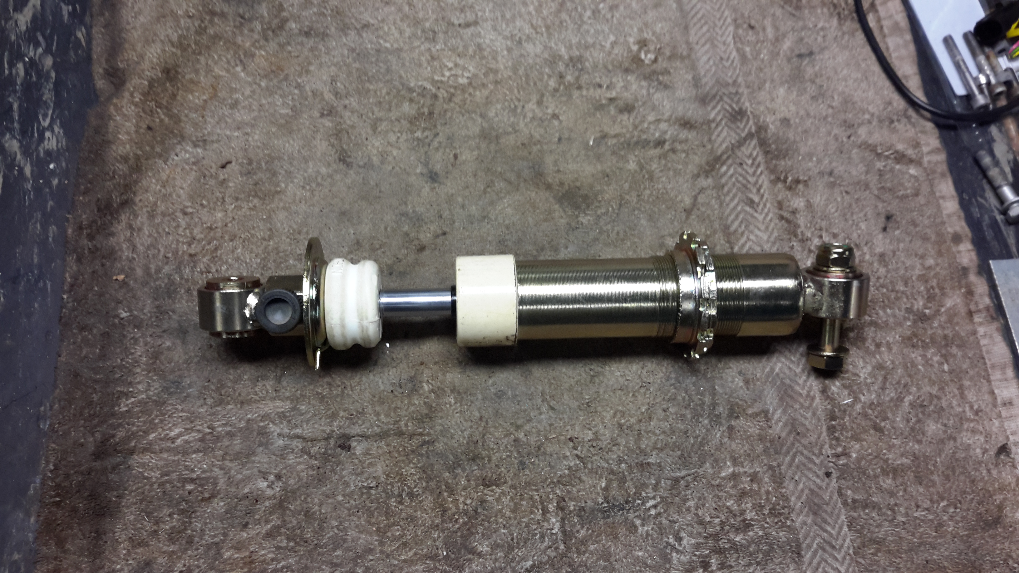

john w Posted March 9, 2017 Report Share Posted March 9, 2017 Thanks for the reply. I removed the dust cover but couldn't compress the cap to get the circlip out. I took it to a local suspension specialist who said it's not intended to be rebuildable, and he said adding a valve to the body is not usually very successful. I'm therefore just having the outside replated with all the shaft etc still in place. I will post some pics when I get it back next week. Cheers, John. P.'s. I am rebuilding a tr32 too, which is essentially the same as your tr33 but no front disc brake. Quote Link to comment Share on other sites More sharing options...

john w Posted March 20, 2017 Report Share Posted March 20, 2017 My tr34 rear shock, after replating and ready for spring fitting. Quote Link to comment Share on other sites More sharing options...
