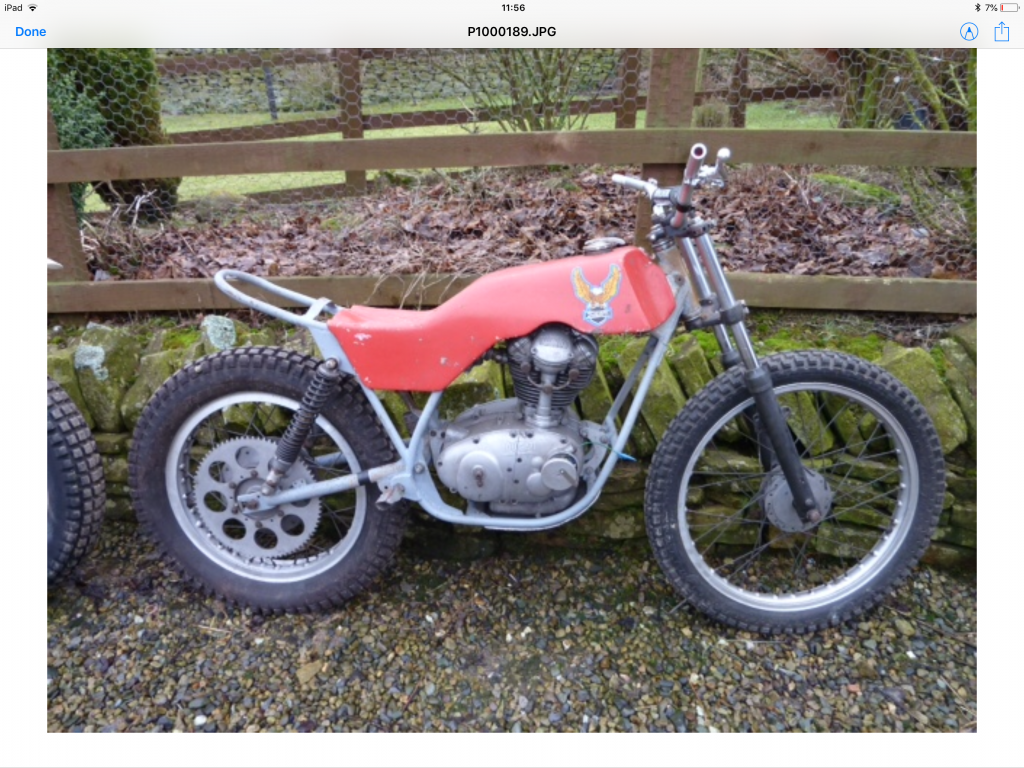

leezy320 Posted July 13, 2019 Report Share Posted July 13, 2019 I sold this bike to Dave Ingram stav Chorley classic bikes Quote Link to comment Share on other sites More sharing options...

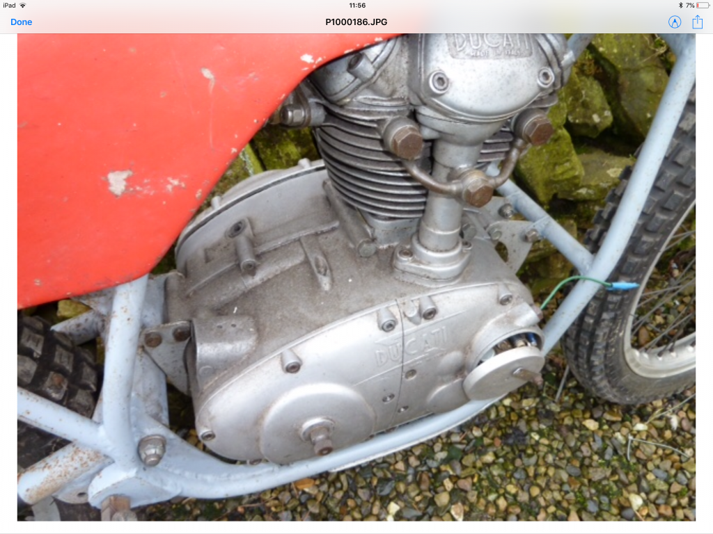

leezy320 Posted July 13, 2019 Report Share Posted July 13, 2019 This is it before you restored it I had it for years was going to restore and do the Scottish on it but never got round to it got a pre65 trials Ducati 250 engine and frame now for sale £1,500 got more pics of your bike if you want them leezy_61@hotmail.co.uk Quote Link to comment Share on other sites More sharing options...
section swept Posted July 17, 2019 Report Share Posted July 17, 2019 On 2/9/2017 at 12:21 PM, trapezeartist said: The double gearlever looks a bit unnecessary. And the humungous rear sprocket might be vulnerable. Surely there's another way to achieve suitable gearing. The ‘double’ gear lever was in the 60’s/70’s a recognised mod, enabling the ride to prod each the front for up changes and prod the rear for down changes. This stopped the ‘fishing’ effect trying to get the boot under the lever to lift the it up to select a gear. Possibly not as effective on later trials bikes due to space confinement. The Ducati engine may have road gearing ratios in the gearbox and possibly close ratio, so not ideal for trials use. By the looks of the bike in the photo fitting a smaller out put drive gear would cause chain to frame clearance issues. Agreed the rear sprocket might be better suited for cutting logs but its not the only special that has worn quite largish rear sprockets. Nice bike, looks well made and its different and very attractive with the current colour scheme. I hope the owner has a great time campaigning the Ducati, lets have more of these ‘specials’. Have a look out for Ras Sport Kawasaki a well thought out bike.?? 4 Quote Link to comment Share on other sites More sharing options...
