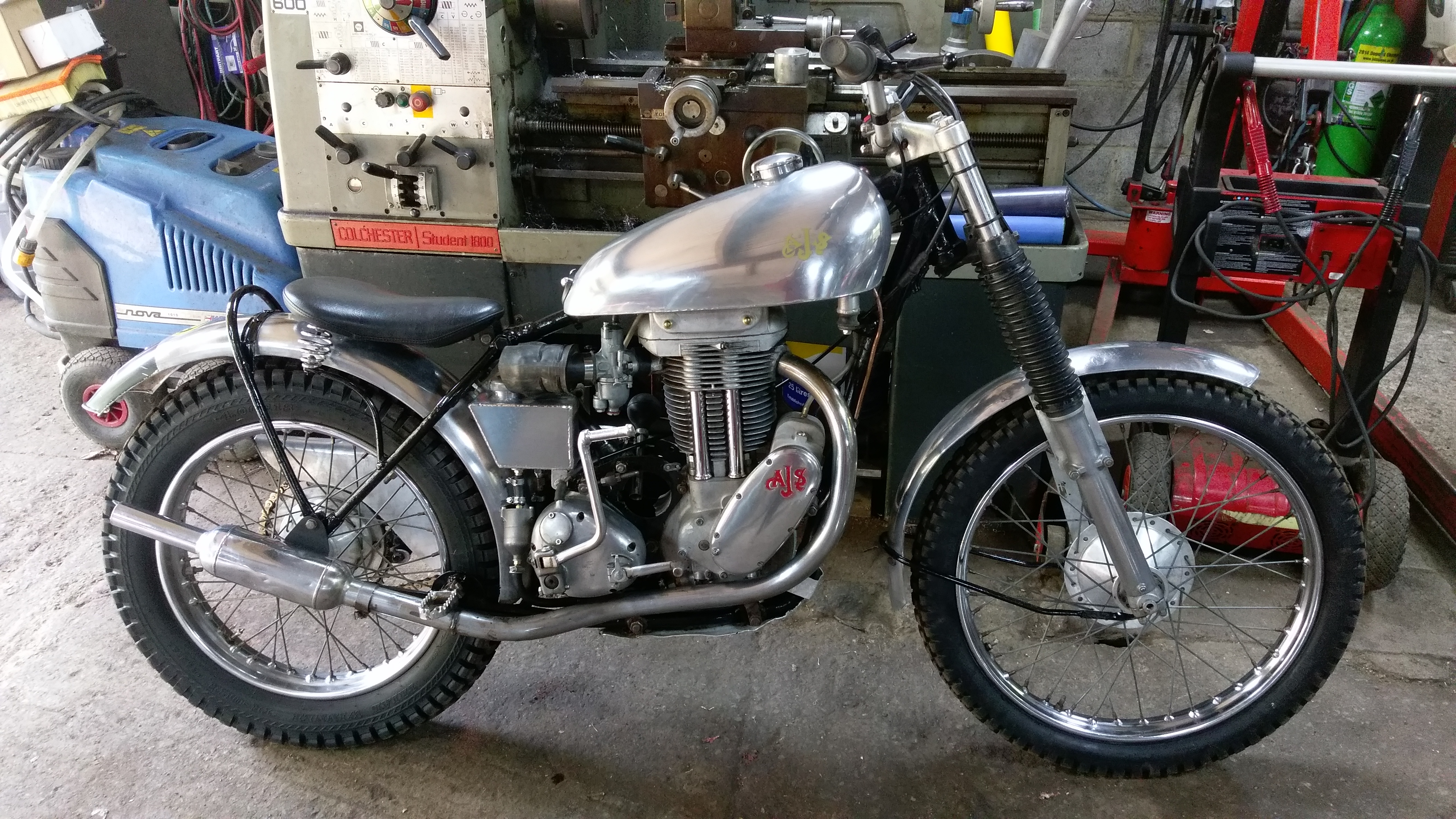

Meanwhile,here is a pic of my old banger...
