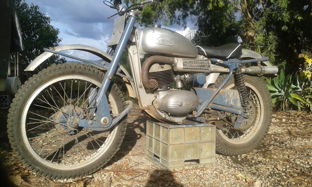

whitehillbilly Posted February 26, 2017 Report Share Posted February 26, 2017 Well Santa has packed his Sleigh away for another year. The Greeves is all ready to go. First Trial Kicks off next week. 4 Quote Link to comment Share on other sites More sharing options...

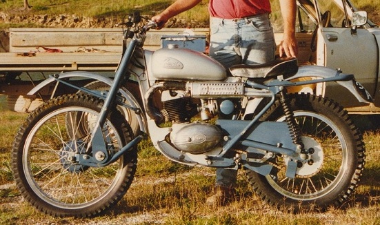

trialsrfun Posted September 23, 2017 Report Share Posted September 23, 2017 (edited) Good to see an original spec Greeves Scottish in trials use, it even has the toolbox fitted. Is the Greeves Moorland blue paint the original finish, I also see what could be TES forks fitted, what changes if any have been made to the bike I notice it has the Villiers carb also the plug lead comes from the mag case so presumably the Villiers ignition system as well? Edited September 24, 2017 by trialsrfun Quote Link to comment Share on other sites More sharing options...
whitehillbilly Posted September 24, 2017 Author Report Share Posted September 24, 2017 Hi Trialsrfum. Yes original, as I got it, 25 yrs ago, as a barn find. I cut of original 'bar' type foot pegs off. Add folding ones. RH side has no spring, so can be folded up to kick start, when cold. starts to the foot peg when warm. Rock guards added, heavy duty, as the sections in Aus can have lots, and big. I added a chain tensioner, and cut an old chopping board, bending around the swing arm, as am running a 12T gearbox sprocket, and It was cutting in a bit. 60 thou OS Hepolite piston. Was 10 thou OS until piston circlip broke, the pin scored the barrel. Had to take it right out to remove score marks, so probably closer to 262cc now ???? Electrics are STD, lead soldered onto coil. Coil was re wound, by HI Output coils, Vic, AU, 20 odd years ago. The paint was matched from sample inside Brake hub, so probably very close to original Moorland Blue. Still have 1/2 ltr in tin for touch ups. Front fork bottom loop is thicker than original type. It was fitted. GRA member thought maybe off SAS model. NJB front and rear forks jacked it up higher than STD. Tool box has spare plug and a few tools in it. Still has the original Swing arm oiler, drip feed metering screw fitted. GRA member, who built the wheels at Greeves, supplied alloy rims and pre cut spokes. Alloy rims same fitted to 63 works bikes. Alloy exhaust, had perforated tube in the middle, packed with insulating wadding, with After market silencer fitted. Before and After. Nice and shiny back then. Whitehillbilly 3 Quote Link to comment Share on other sites More sharing options...
