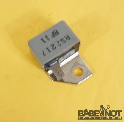

monkster Posted March 1, 2017 Author Report Share Posted March 1, 2017 im just wondering would the voltage regulator module or this we thing in picture cause this or cdi unit? Quote Link to comment Share on other sites More sharing options...
