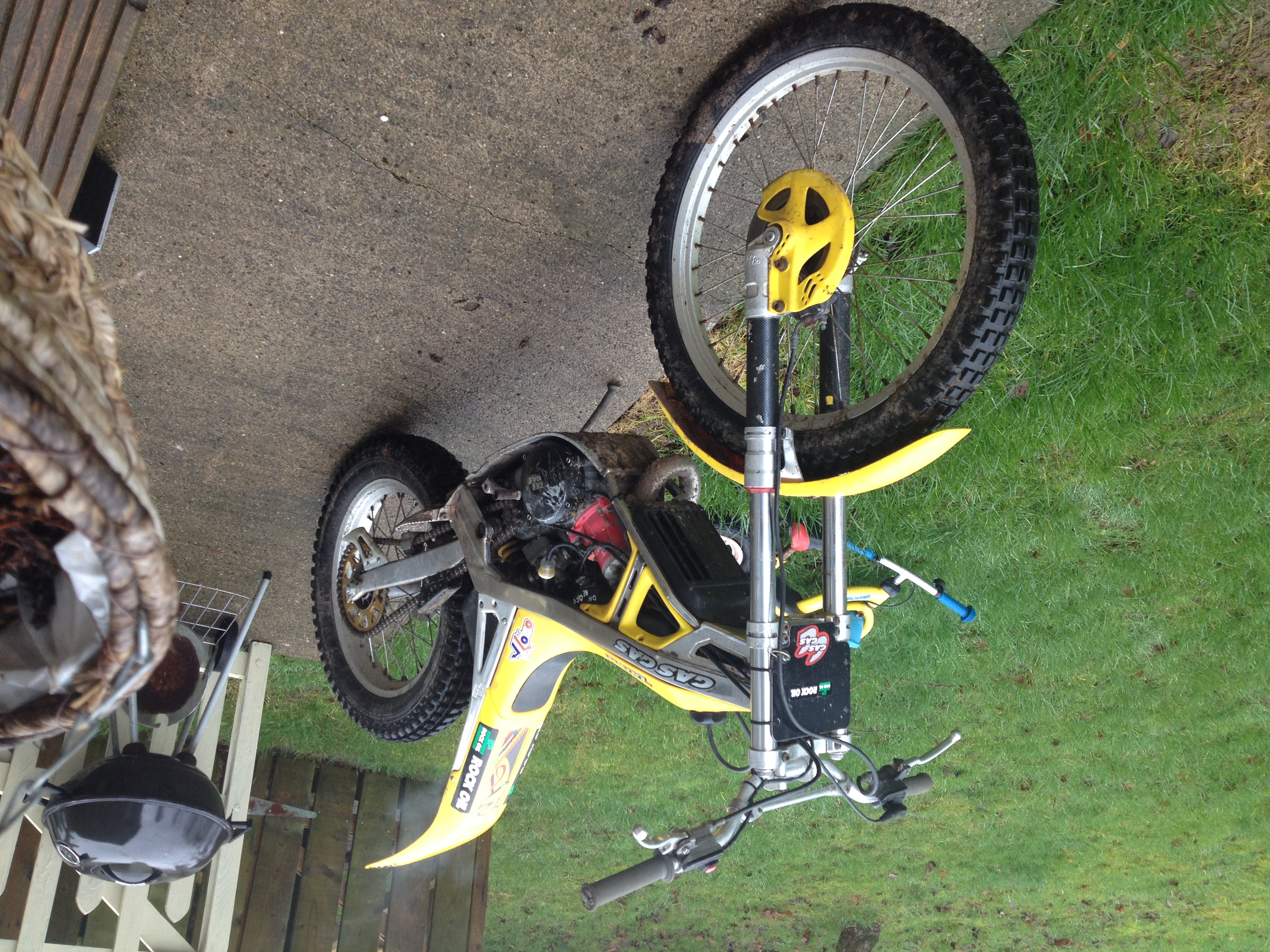

strugglinon Posted March 3, 2017 Report Share Posted March 3, 2017 So I've got myself another project bike. '93 JTR160 with a 250 motor in it as the previous owner couldn't find a 160 piston. it starts 2nd kick no problems, runs off choke happily. After 5-10 mins or so it's revs begin to pick as if the dry side main seal is passing air. let it cool down and it's back to normal. ill do a vacuum test on it this week, but could it be a stator problem? any suggestions? graeme Quote Link to comment Share on other sites More sharing options...

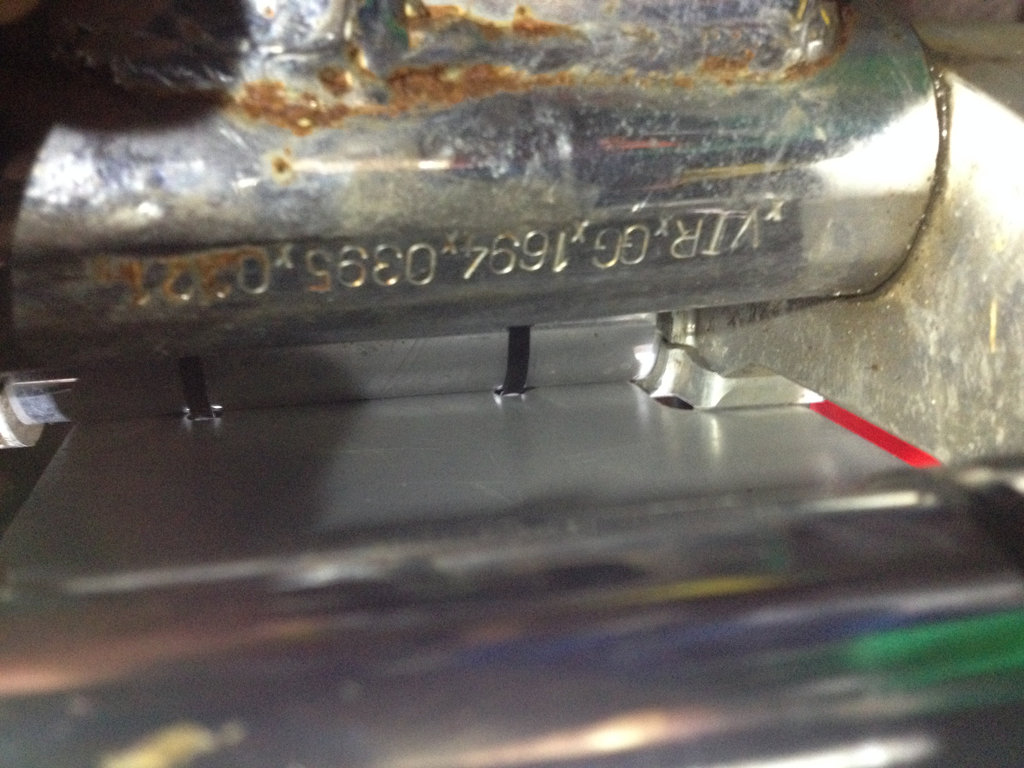

strugglinon Posted March 3, 2017 Author Report Share Posted March 3, 2017 I meant '94 not '93. took it as a '94from the frame number? "1694" (160cc 1994)? do you know the year from the frame number? regardless of that, any ideas on the running issues? Quote Link to comment Share on other sites More sharing options...
strugglinon Posted March 3, 2017 Author Report Share Posted March 3, 2017 Thanks for the clarification. It rides really nicely. Just got sort out this problem, then I can concentrate on tidying it up a bit. Quote Link to comment Share on other sites More sharing options...

strugglinon Posted March 9, 2017 Author Report Share Posted March 9, 2017 Ok, I've put a new main seal in on the dry side. carb has been cleaned in the ultrasonic bath. can anyone tell me what size the pilot jet should be? the motor is behaving the same way. Revs begin to rise steadily then level off. A bit of choke settles it down, so it's still running lean. hmmmmm? Quote Link to comment Share on other sites More sharing options...
